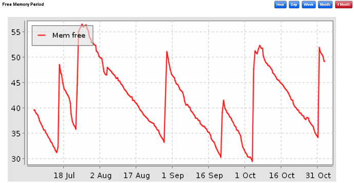

Anyway, when it’s killing anything while you’re just at 50% mem usage something’s badly wrong (assuming your chart is right). I’d disable the OOM killer. See bottom of this link how to configure it.

For all it is worth; I did some further digging… and eventually disabled Grafana, which I installed a few months ago, but did not end up using (not wanting to spend the time with it on OHv1, having the idea of migrating to OHv2) and left it sitting there idling.
After stopping grafana, memory free stayed at the previously experienced 60% free.
I have now uninstalled grafana on the the OHv1 rPi… and all seems fine again.
