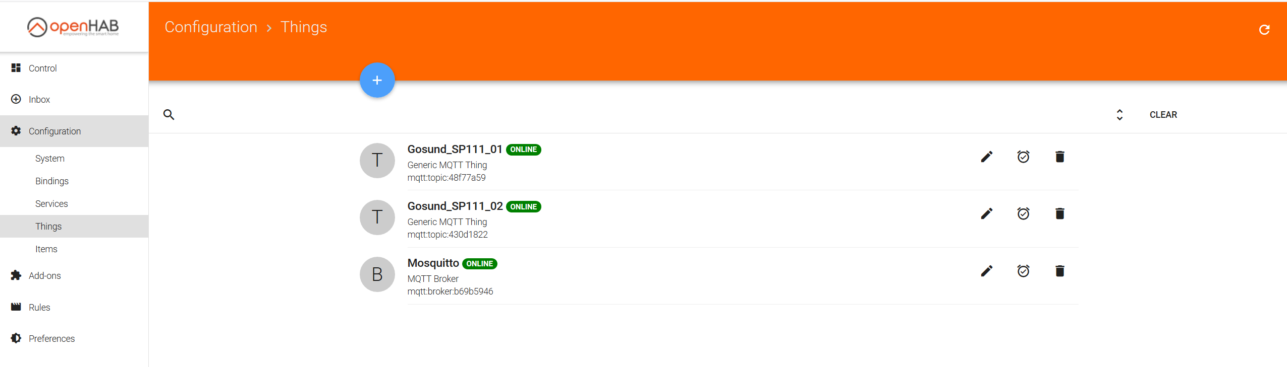

Hey Guys,
iam new with OpenHab and i got a problem which iam not able to solve, maybe some of you experts have some tips for me to solve my problem.
I have two Plug-Switches from Gosund (SP111) flashed with Tasmota. I have bind them to OPenhab via PaperUi and the switches are working, but when i switch one Plug on then the other switches on at the same time.
Do you have any explanations from me why the Plug does so?
Iam using OpenHab 2.4.0 with the MQTT binding 2.4.0.
My Configuration can be seen in the screenshot:

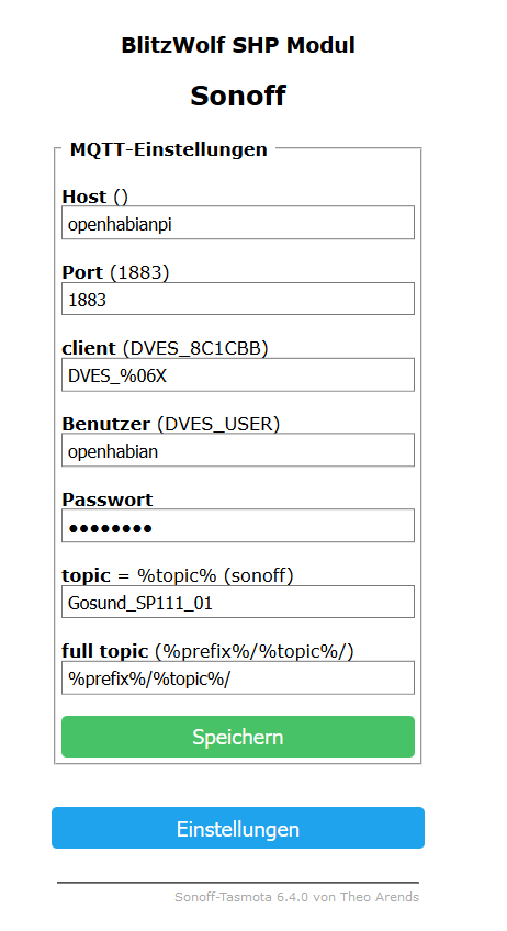

Hey Guys,

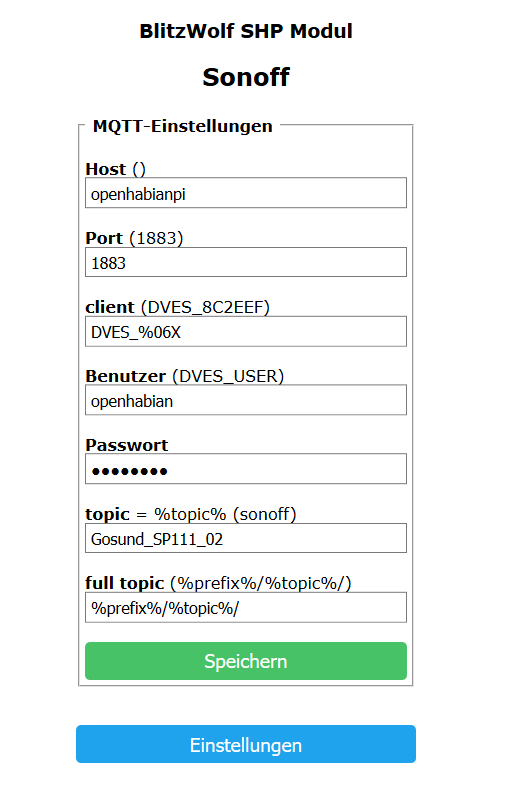

thank you for your fast responses. Here are two screenshots of my MQTT configuration in Tasmota:
From my point of view it seems to be configurated correctly, but maybe i oversee something.
@H102 : I have read this topic and i have no idea at the moment why this is not working.
Maybe some off you can give me the decisive hint.
Best regards,
Markus

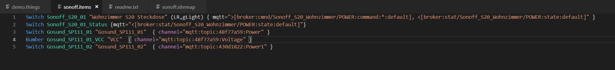

And here is the screenshot of my item file:

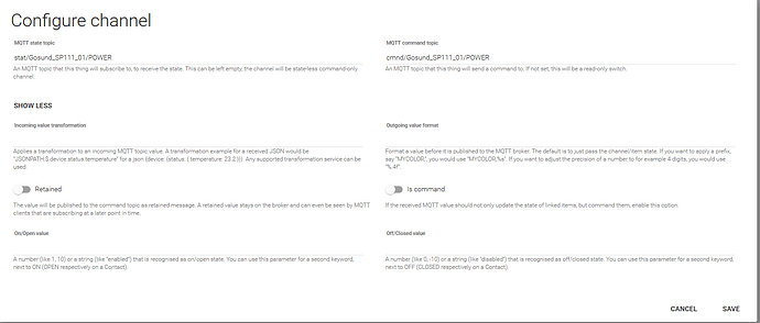

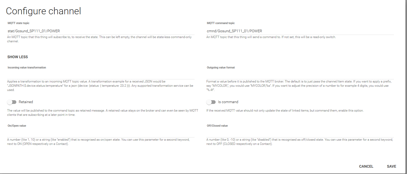

Screenshot of Channel Config:

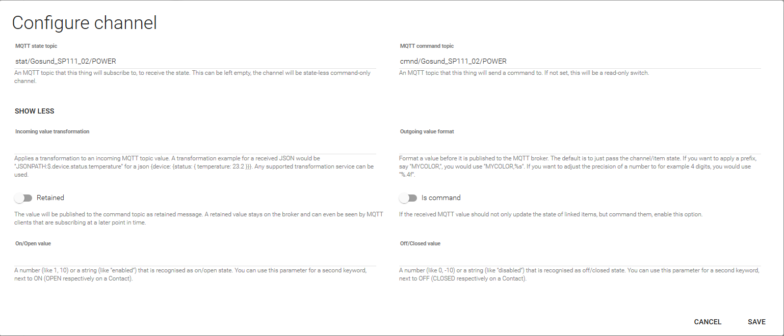

Screenshot of second Channel Config:
