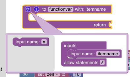

But first I’ll answer the XY Problem. To create a function that takes an argument click the cog icon on the function block and drag one “input name” for each argument to pass to the function.
Then when you add the call function block you’ll have a slot for each input name.

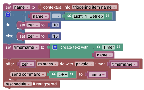

Close to a one-to-one block to line of code translation into Blockly is as follows:
The Java Script these blocks generate become:
var name2, zeit;
name2 = event.itemName;
if (name2 == 'Licht_1_Betrieb') {
  zeit = 10;
} else {
  zeit = 15;
if (cache.private.exists(('Timer' + String(name2))) === false || cache.private.get(('Timer' + String(name2))).hasTerminated()) {
  cache.private.put(('Timer' + String(name2)), actions.ScriptExecution.createTimer(('Timer' + String(name2)), time.ZonedDateTime.now().plusMinutes(zeit), function () {
    name2.sendCommand('OFF');
} else {
  cache.private.get(('Timer' + String(name2))).reschedule(time.ZonedDateTime.now().plusMinutes(zeit));
which is pretty close to my rewriting.

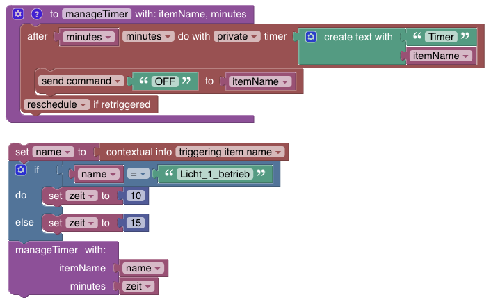

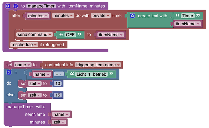

In that case the following should work. Move the creation of the Timer to a function. The variables should become fixed inside the context of the function so they don’t get overwritten on subsequent calls to the rule.

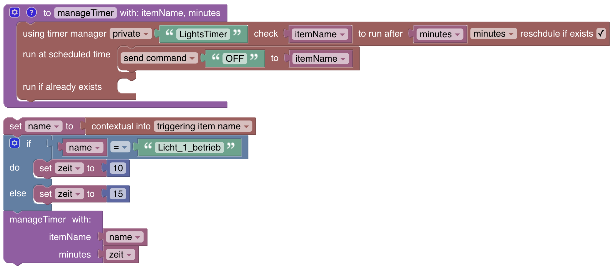

You know what, I completely forgot about my own library. :nerd_face:
I have a library for which I’ve created a block library which has a Timer Manager built to handle a case like this.
Obviously expire is the correct end solution but in the more general case where you have one timer per Item Timer Manager can be very powerful.
I am not sure if the function is required with Timer Manager to fix the variables. I’d need to look at the code to double check so I’ve left it in a function.
It doesn’t really add much in this one case but if you need to detect flapping it can handle that for you.
