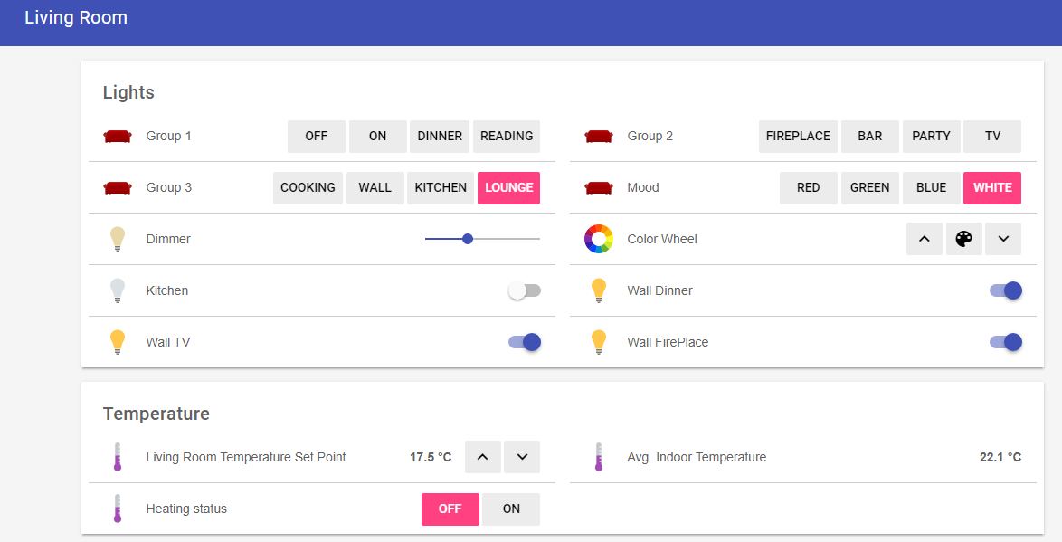

That did the trick, you are awesome!! But it introduced a new problem!
So I have 30% of my lights in group Group_DMX_LivingRoom off, then I dim the lights with the dimmer or the color wheel, but then it turns all lights on!!
which means that this expression l.state.toString != hsbOff somehow is not working!

The result of my lighting scheme can be seen here:
Only thing left to implement now is that I can combine switch items and Color Items so that I can loop through the entire light group instead of
