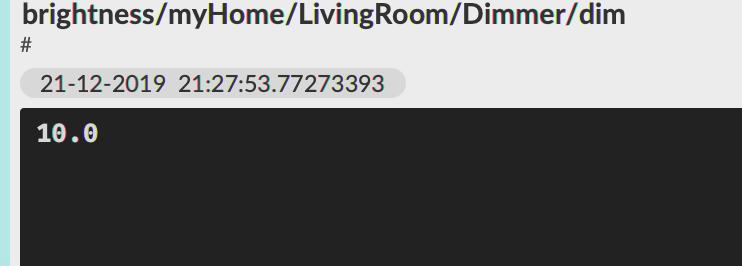

The percentage value is transmitted with 1 digit after the decimal separator e.g. 10.0 for 10% via mqtt. The chem device can not handle “10.0” because it expects “10”.
I tried to use Outgoing value transfer in the openhab Paper UI. But the value on mqtt is still “10.0”.

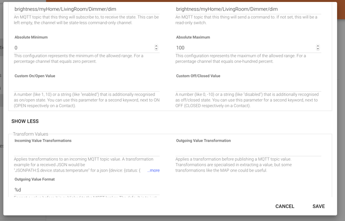

Click the pencil icon to edit the channel, then click show more on bottom left. Change the %s to %d and click save.
My best guess with limited info given.:upside_down_face:

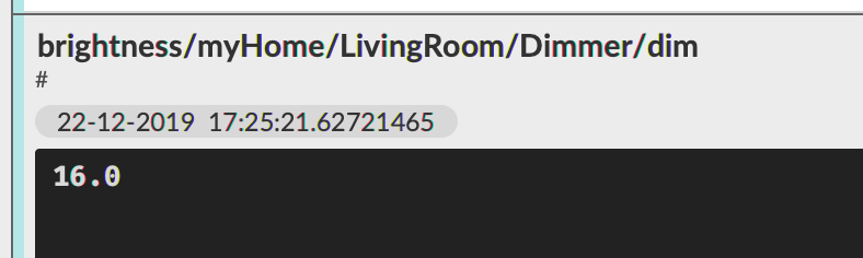

Unfortunately this was my first try. Whatever I tried it did not change the variable value e.g.:
Outgoing Value Format:
empty definition → 16.0
Test %d → Test 16.0
%d → 16.0

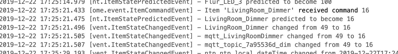

The OH log is showing the number without the decimal. Where are you having an issue with the decimal point, when sending it back to the device?
You are right. The OH log shows it without the decimal but the MQTT Broker receives the value with the decimal.
OH is publisher → FHEM is subscriber
The device which is controlled via FHEM does not accept the value with decimal.
