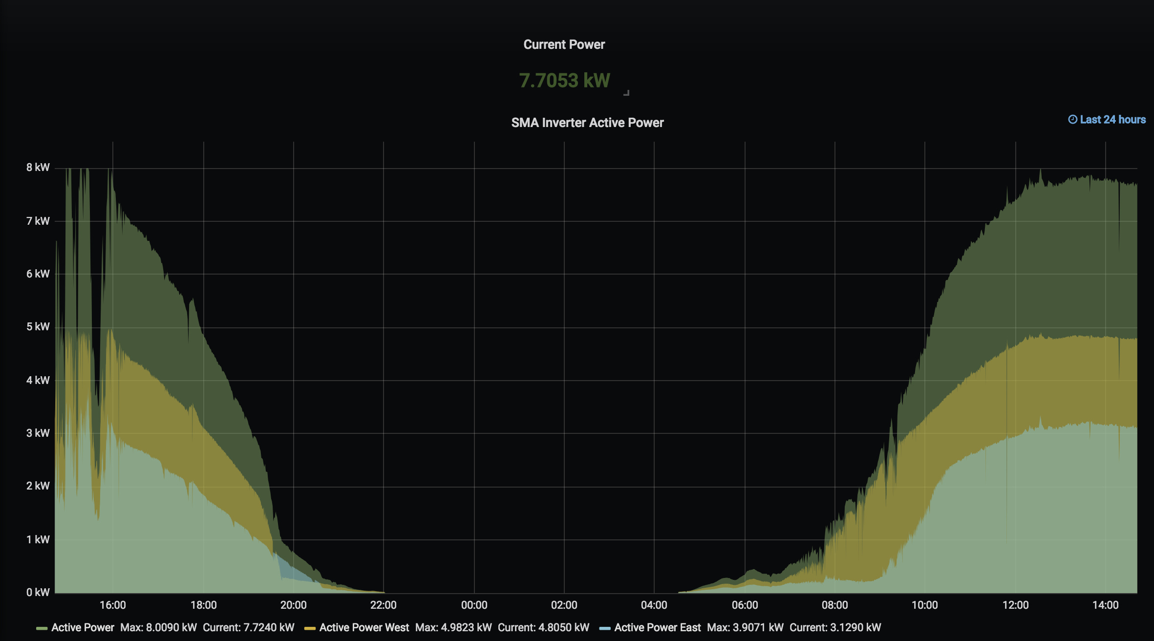

In my case I have an Solar inverter, when there is not sufficient sun the inverter generates “fake” values and therefore I want to filter out values out of the range og 0-8 Kw - it works perfect not :slight_smile:
