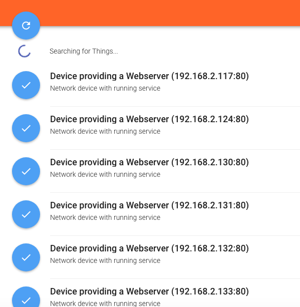

It is strange because from INBOX in OH Paper UI, if I click on + in order to see if OH find the phone device IP. It does not show the phone IP.
I will try another one.
Is this right that I do not see my phone IP here in the inbox? I should see it, right?
I have read the doc again, and it seems I have setup everything fine, but OH does not see my device connected. It is not reachable. I have checked that WIFI is enable during standby. So, the problem is over there, OH does not see my device conected to my wifi, that the reason because when binding goes OFF works fine, but not when trying to go ON, because OH does not detect the phone. why?
During the scan, phone is not detected. I can see other devices but not the phone. :confused:
