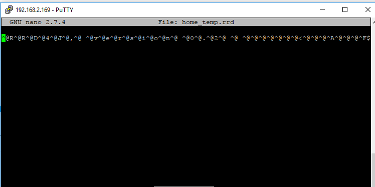

you mean that :
/var/lib/openhab2/persistence/rrd4j:
home_temp.rrd file:
Please ,how can you see the date (time)?

Ups, I have to take that back a bit. The timestamps are 840 seconds, but that is the setting of the archive no. 3 (14 minutes).
Yes, remove this file and start again. The .rrd file can NOT be looked at usefully using an text editor!
Using the REST API you can look at the contents!

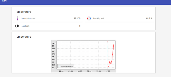

It is working now.
after installation
sudo openhabian-config
Go to ā€œ20 Optional Componentsā€ > ā€œ24 InfluxDB+Grafanaā€ <>
After installation and reboot:
Weird isn’t it. Must reset some shared parameters somewhere.
thank you for your reply, yes it’s Weird
Yes, weird!
