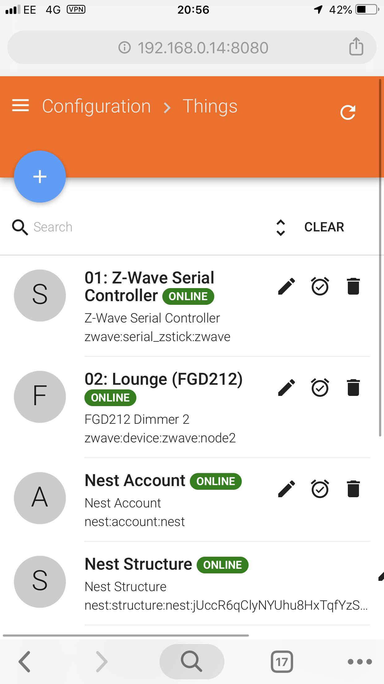

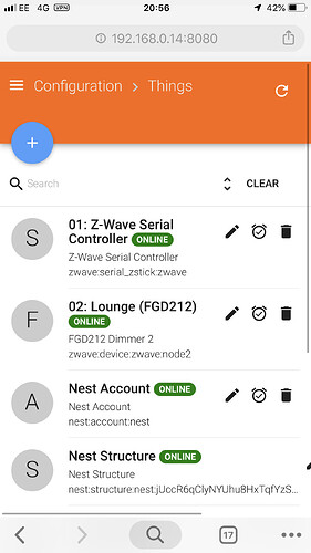

I can connect the Nest Account in the Paper UI and in doing so the Structure discovers OK however the thermostat does not appear.

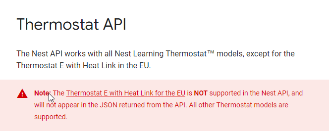

Oh dear, tried using the HTTP binding and the Nest V1 Binding without success. I then did more research and answered my own question. The Nest E thermostat is not supported in the Nest API in the EU. :sob:
