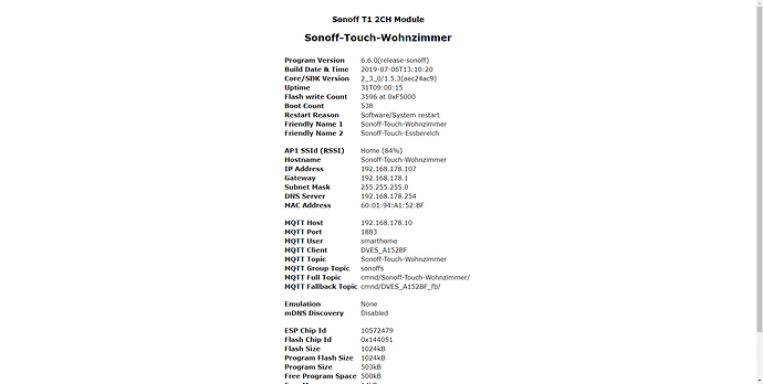

these are my settings on tasmota:

i know whats wrong, the wrong topic, thank you very much for the help.
this are the right syntax:
Thing topic Sonoff_Touch_GF_Living_and_Eat "Sonoff Touch Wohnzimmer und Essbereich" @ "Wohnzimmer" {
Channels:
Type string : reachable "Reachable" [ stateTopic="tele/Sonoff-Touch-Wohnzimmer/LWT" ]
Type switch : power1 "Essbereich" [ stateTopic="stat/Sonoff-Touch-Wohnzimmer/POWER1", commandTopic="cmnd/Sonoff-Touch-Wohnzimmer/POWER1", on="ON", off="OFF" ]
Type switch : power2 "Wohnzimmer" [ stateTopic="stat/Sonoff-Touch-Wohnzimmer/POWER2", commandTopic="cmnd/Sonoff-Touch-Wohnzimmer/POWER2", on="ON", off="OFF" ]
Type number : rssi "WiFi Signal Strength" [ stateTopic="tele/Sonoff-Touch-Wohnzimmer/STATE", transformationPattern="JSONPATH:$.Wifi.RSSI"]
