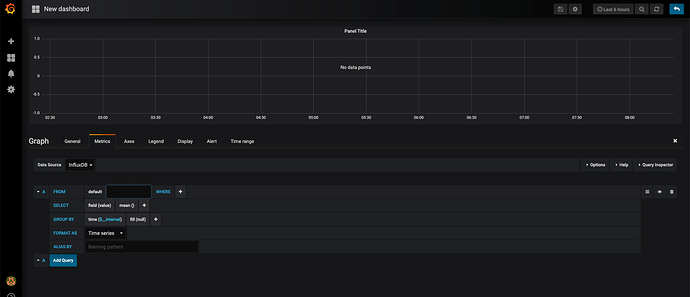

And when I add the data source on Grafana I don’t found any point on the graphs.

  3. How do I have to config the graph on Grafana, I think I’m not doing well. (The data source is config properly because the test is OK).

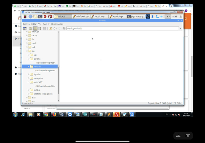

Then, I have entered to the log folder, seeing the link you have attatched me and on InfluxDB folder, there’s nothing. No log.
On the openHAB log folder, yes, there are some log files which not include any InfluxDB log.
