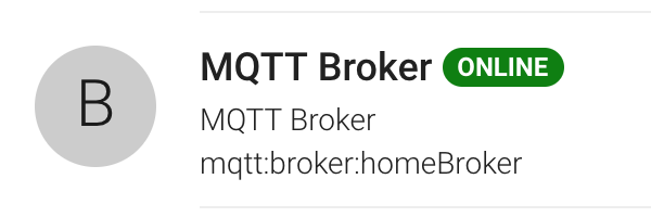

I have created the broker thing through Paper UI and it works for other use cases in OH (such as receiving values and assigning them to OH items):
        mqttActions.publishMQTT("Garage/TorLinks/oben", Garage_Kanal_3.state.toString)
