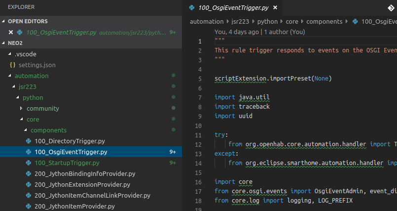

    Now I’m starting to move slowly my rules to this but I can not understand what I need to setup in order to have autocompletion working and avoid “unresolved import” errors in VSCode :
These are pylint errors only, your scripts should work fine. Can disable them for a while file, a block, or a single line. I don’t remember the exact way but look in the pylint docs.
You won’t need to do it for anything in automation/lib/python if you add that to your Python path in your vscode workspace. I’m on my phone so I can’t look at mine right now to give you a more detailed example, but again, look in the vscode docs for Python paths.
The Helper Library imports are not recognized because they are not in a path in syspath. The rest are Java or openHAB packages that are not available to the Python context that pylint is running in.

I confirm that my scripts works well, it’s not my point. My point is “can I have VSCode configured in a way he does not identify false errors, and even more…points me to real errors :slight_smile: ?”
If so, how to do that ?
You won’t be able to have VSC figure it out automatically unfortunately. There are ways around it though.
First you can get pylint to see the Python libs by creating a file {openhab_conf}/.env and adding this:
PYTHONPATH="./automation/lib/python"
Second you can exclude the Helper Libraries from pylint, since they are not strictly part of your openHAB conf::
    "python.linting.ignorePatterns": [
        "**/automation/**/python/core/**/*.py",
        "**/automation/**/python/community/**/*.py"
And lastly, in any files you create, you can put pylint directives around the import blocks it won’t be able to resolve:
# pylint: disable=import-error
from org.openhab.core.library.items import SwitchItem
# pylint: enable=import-error
Further reading about pylint Message Control and VSCode Python Linting might help you get this just to your liking
Edit: update ignore patterns to recurse directories under core and community
Edit: I have made a PR to the Helper Libraries documentation that will add a page detailing these steps.
