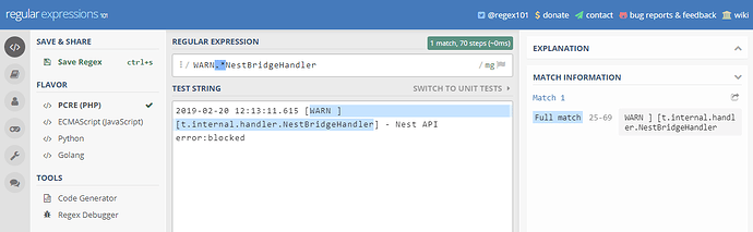

This RegEx performs as expected in the LogReader binding Thing definition - i.e., a log message with that string triggers the log reader.
Rich - I finally figured out how to modify the regular expression to add parentheses as you suggested. This code does what I was after.

The REGEX Transform needs to match the whole String and put parens around the parts you want to extract. regex101 doesn’t require this so you can match parts of a String and get a match.
At a minimum, you need to add a .* to the front and back of your expression. Then you need to add parens around that part of the String you want to extract.

Well you just implemented what I described, only your regular expression is a little more specific. My regular expression will work with any log statement that follows the pattern. Your regular expression does essentially the same thing but it only works with WARN level log statements from the NestBridgeHandler.
I do see that my regular expressions are missing the escapes for the [ and ] which I would need.
Put into words, your regular expression means:
  1. .* matches all the characters up to the first \s[WARN
  2. The second .* matches all the characters after \s[WARNuntil the first instance of NestBridgeHandler]
  3. The third .* matches the rest of the String.
The placement of the parens say we want to return everything that matches inside the parens. In this case, 2 above.
We need 1 and 2 above though so that the expression matches the whole text.
Note that this is not standard REGEX behavior and that is why you didn’t see the same results as when you used regex101.
