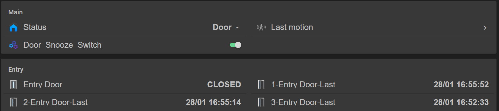

i have two items defined as below
DateTime mqtt_sensor_door_LastUpdate1 "1-Entry Door-Last [%1$td/%1$tm %1$tH:%1$tM:%1$tS]" <clock> (gChart,gHistory)
DateTime mqtt_sensor_door_LastUpdate2 "2-Entry Door-Last [%1$td/%1$tm %1$tH:%1$tM:%1$tS]" <clock>
I want from a rule to get the difference in minute and Sec between mqtt_sensor_door_LastUpdate1 and DateTime mqtt_sensor_door_LastUpdate2
Please, Could someone assist?
