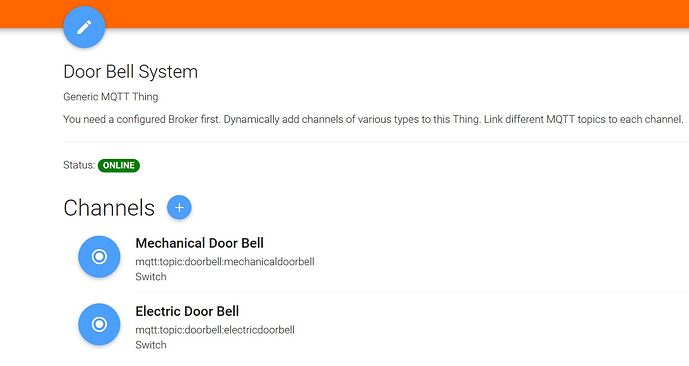

Anyhow, the rule does NOT receive messages from the mqtt channel defined thru PaperUI. I copied the channel after I have created it: mqtt:topic:maindoor:contact and added it to the rule.

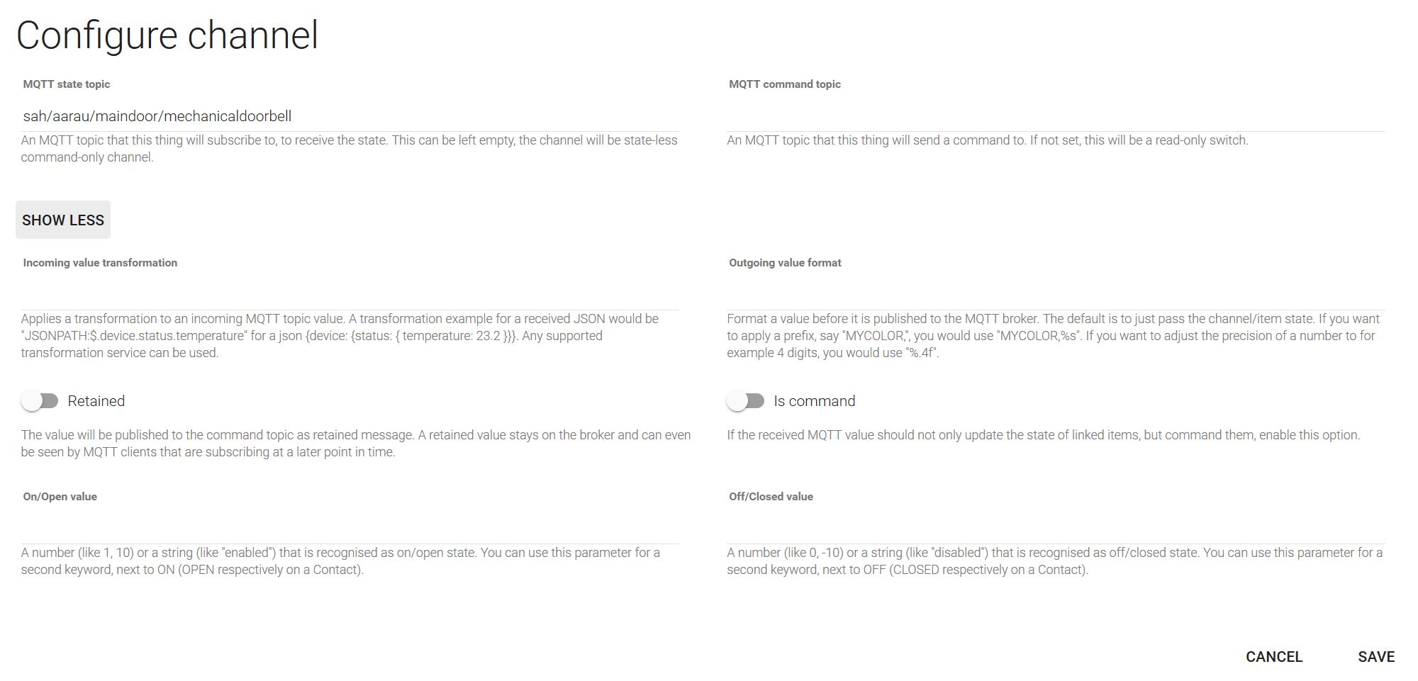

I clearly miss out on how to configure the consumption of mqtt messages with items or channels, since the messages are evidently delivered to the mqtt broker. What am I missing from the documentation?
I have not clue how that would look like in the ItemChannelLink.json file after entered in the PaperUI.
In the Thing.json file I have found what you propably are looking for. Where the mechanicaldoorbell is matched with the topicsah/aarau/maindoor/mechanicaldoorbell of the mqtt broker
It is only a ON. (A OFF is never sent. It’s assumed to be the default state. A debouncer ensure the signal is only sent once every 5 seconds so that no one can storm-signal the mechanical door bell)
