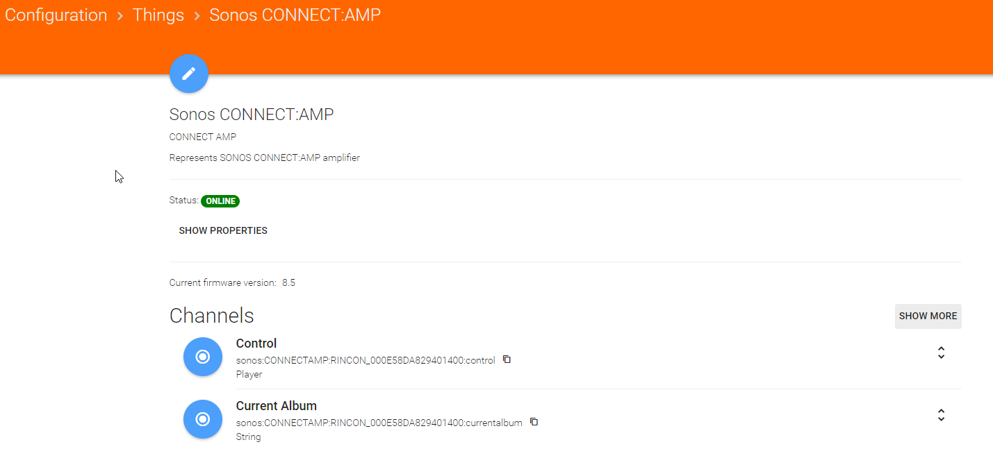

say("Kinder",  "pollytts:Marlene", "sonos:CONNECTAMP:Esszimmer")

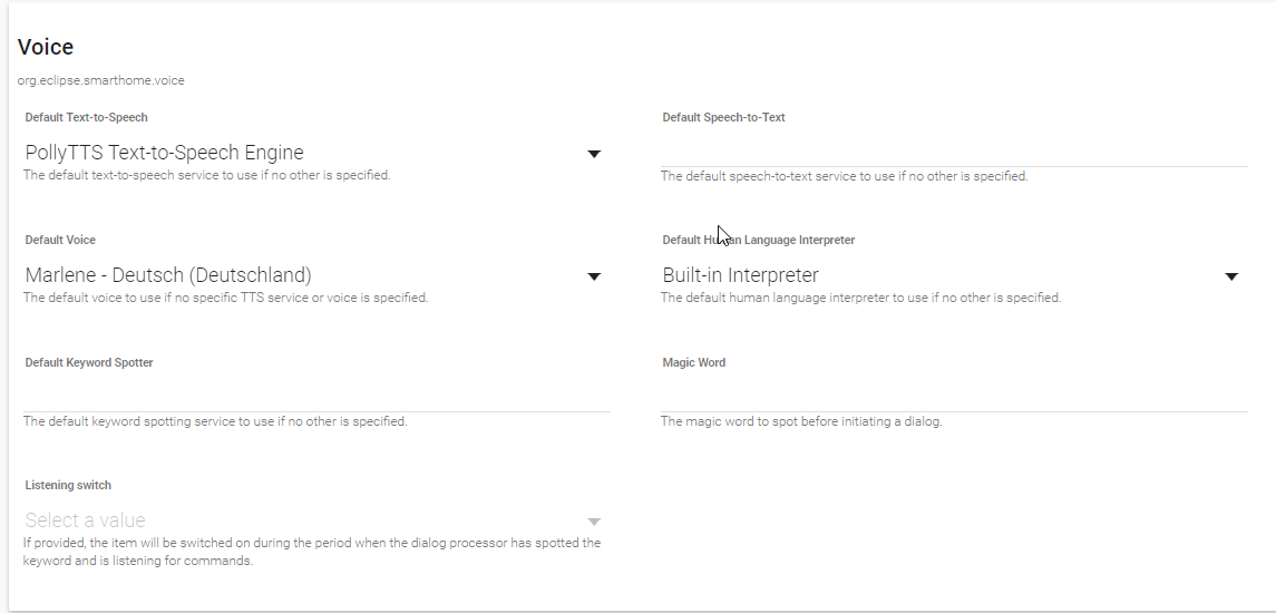

What works:
say("Kinder")
using from PaperUI: same Sonos player as default audiosink, Polly TTS Engine, Marlene.
Read for this one in log:

Q: How to get the syntax right/define which sonos audiosink should be used in the say () command?
Much inspiration from many sources but did not find a solution:
OH Documentation Multimedia SAY()
that would state:
say("Hello world!", "voicerss:enUS", "sonos:PLAY5:kitchen")

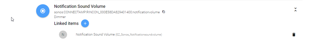

Sonos Notification
items:
Group EZ_Sonos (Sonos)
Player EZ_Sonos_Control                 "Control"                   <sonos_control>      (EZ_Sonos)            {channel="sonos:CONNECTAMP:Esszimmer:control"}
String EZ_Sonos_CurrentAlbum            "Album [%s]"                <sonos_album>        (EZ_Sonos)            {channel="sonos:CONNECTAMP:Esszimmer:currentalbum"}
String EZ_Sonos_CurrentArtist           "Artist [%s]"               <sonos_artist>       (EZ_Sonos)            {channel="sonos:CONNECTAMP:Esszimmer:currentartist"}
String EZ_Sonos_CurrentTitle            "Title [%s]"                <sonos_title>        (EZ_Sonos)            {channel="sonos:CONNECTAMP:Esszimmer:currenttitle"}
String EZ_Sonos_CurrentTrack            "Track [%s]"                <sonos_track>        (EZ_Sonos)            {channel="sonos:CONNECTAMP:Esszimmer:currenttrack"}
Switch EZ_Sonos_Led                     "Led"                       <sonos_led>          (EZ_Sonos)            {channel="sonos:CONNECTAMP:Esszimmer:led"}
Switch EZ_Sonos_Mute                    "Mute"                      <sonos_mute>         (EZ_Sonos)            {channel="sonos:CONNECTAMP:Esszimmer:mute"}
String EZ_Sonos_NotificationSound       "Notification Sound [%s]"   <sonos_notification> (EZ_Sonos)            {channel="sonos:CONNECTAMP:Esszimmer:notificationsound"}
Dimmer EZ_Sonos_Notificationsoundvolume "Notification Sound Volume" <soundvolume>        (EZ_Sonos)            {channel="sonos:CONNECTAMP:Esszimmer:notificationvolume"}
String EZ_Sonos_State                   "State [%s]"                <sonos_state>        (EZ_Sonos)            {channel="sonos:CONNECTAMP:Esszimmer:state"}
Switch EZ_Sonos_Stop                    "Stop"                      <sonos_stop>         (EZ_Sonos)            {channel="sonos:CONNECTAMP:Esszimmer:stop", autoupdate="false"}
Dimmer EZ_Sonos_Volume                  "Volume"                    <soundvolume>        (EZ_Sonos)            {channel="sonos:CONNECTAMP:Esszimmer:volume"}
String EZ_Sonos_ZoneName                "Zone Name [%s]"            <sonos_zone>         (EZ_Sonos)            {channel="sonos:CONNECTAMP:Esszimmer:zonename"}
Sitemap works as well and updates.

Please post the settings for Default Voice and Default Sink from PaperUI and an (not working) say command with three strings.

Another possible failure could be the notificationsoundvolume, Did you set it for all players? If not it could be zero for the player used, however if you are handing over the default sink it should work, since it worked with the say command when stating only one string.
Here are the defaults set in the Paper UI:
As well as the Sonos Thing/ the first channels from the PaperUI:
(Item definitions see first post pls)

I have an item for the notificationvolume and setting this as a separate line before the say() command. I can set it to 10, 50, 100 and it works well (I did read your previous posts and some others about some challanges re notificationvolume and wanted to circumvent it by setting it explicitly).

Just did a test at my system, when using the name given by you for the Sonos thing (like sonos:CONNECTAMP:Esszimmer) in the rule it did NOT work. When using the thing name as given by the system (like: sonos:CONNECTAMP:RINCON_xxxxx1400) it did work!
Cool ! I thought I had tried that before … let me redo it !
… it works, great !
