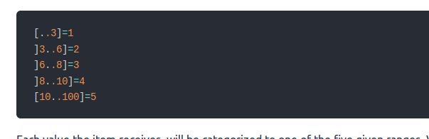

I’ve never used the scale transformation but looking at the doc’s here:
https://www.openhab.org/addons/transformations/scale/#example
the brackets may need to be changed/reoriented ??

I didn’t see this example in the doc’s but other than the first and last entry would the result be the same if the left bracket only was turned ( i.e. ]1..4]=Light Air ) or what is the difference?
[1..3]=Light Air
[4..7]=Light Breeze
Stops at 3 inclusive and starts again at 4 inclusive
[1..4[=Light Air
[4..7]=Light Breeze
Is continuous
1 to 4 exclusive and then 4 inclusive to 7 exclusive
