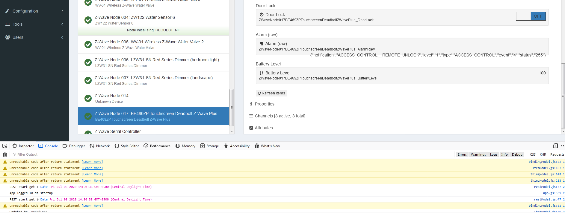

Same errors in current FF. Does it pull those all from the REST? Oddly I have a few LZW31-SN red dimmers and I can edit those fine.

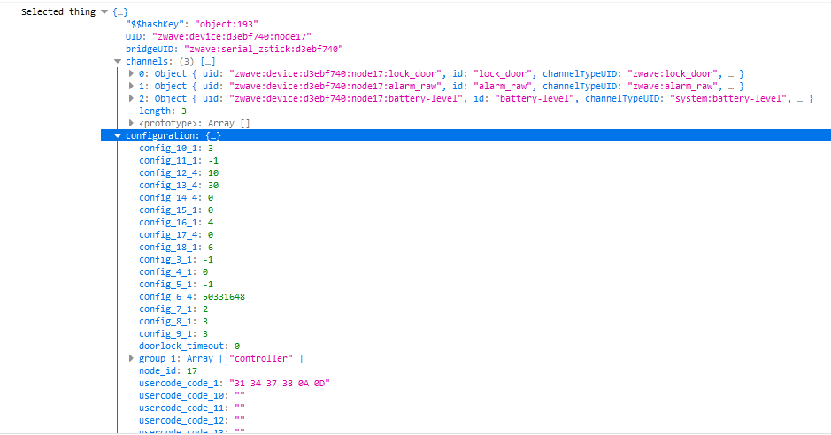

Actually.. I can see the editable bits when I drill down. Am I maybe missing something in Hadmin to parse that?
in FF:
All of the UIs use the REST API to get their data. It looks as if the data is returned, but is not able to be displayed.

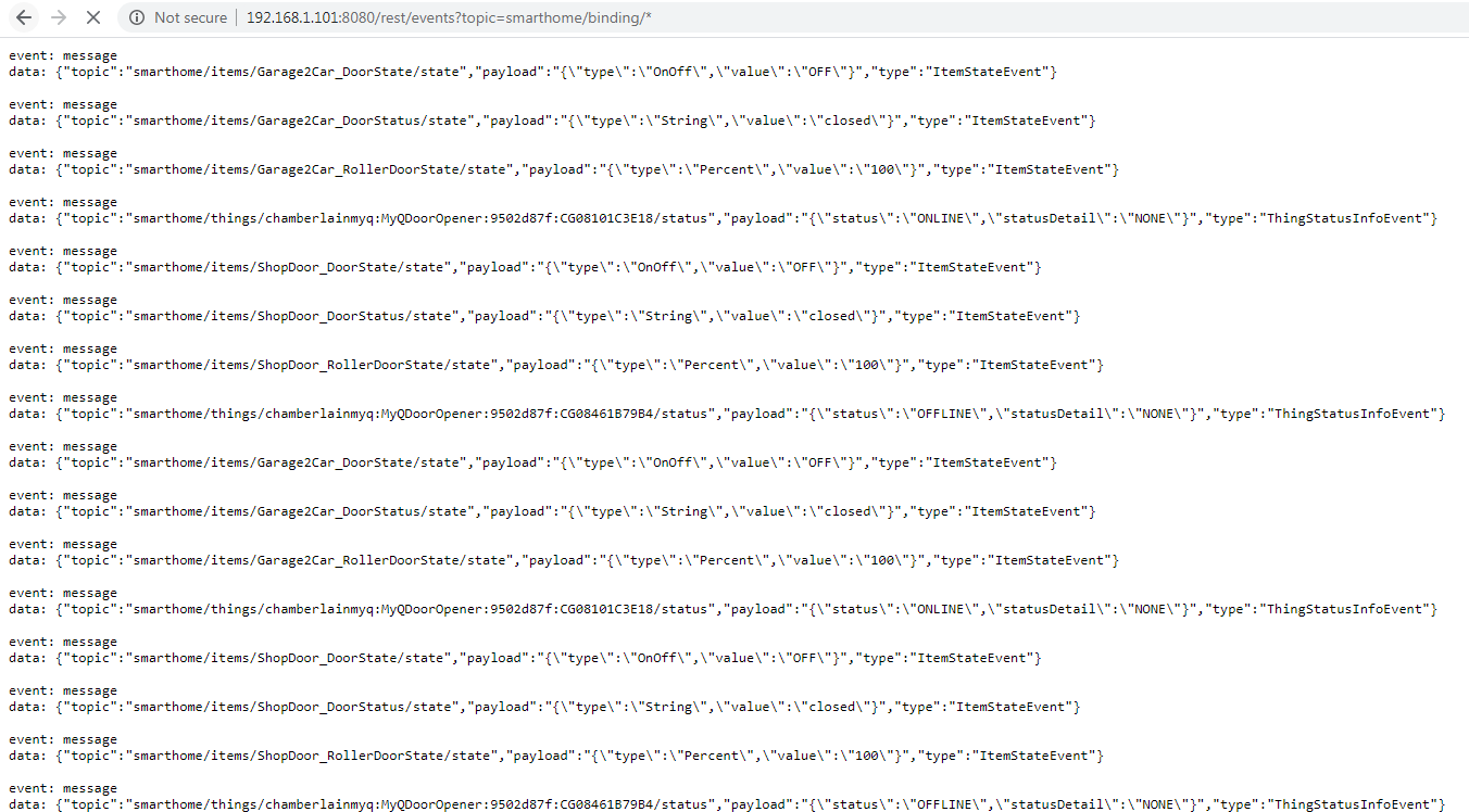

Has 30 so not sure if this is the same on yours or mine maybe has an off js file. But in bindingModel.js
32: eventSrc = new EventSource("/rest/events?topics=smarthome/binding/*");
And if I take the parameters off the query I get events. They’re all singular (topic) so if I try that (http://192.168.1.101:8080/rest/events?topic=smarthome/binding/*) I get something back. Maybe the JS isn’t the most updated?
If I request: http://192.168.1.101:8080/rest/events?topics=smarthome/binding/* I get nothing back.
@5iver 30 user codes per the node’s xml and all are populated with:
                <entry>
                  <int>30</int>
                  <userCode>
                    <state>AVAILABLE</state>
                    <code>30 30 30 30 0A 0D</code>
                    <outer-class reference="../../../.."/>
                  </userCode>
                </entry>
              </userCodeList>

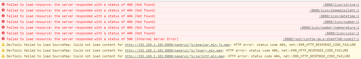

This is the same as mine, so number of codes looks unrelated. What do you see on the network tab? I see three 404s, but everything appears to display properly.

http://192.168.1.101:8080/rest/config-descriptions/thing:zwave:device:d3ebf740:node17
Definitely looks the 500 is the kicker here.
{"error":{"http-code":500,"exception":{"class":"java.lang.NullPointerException"}}}

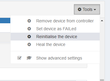

It’s possible the lock didn’t include all the way. You might want to try reinitialization for this node from habmin:
Hrm So that has me thinking that it might not have setup and initialized right. odd because I can see the 3 channels and able to see /rest/things/zwave:device:d3ebf740:node17/ just not the /rest/config-descriptions/thing:zwave:device:d3ebf740:node17
I might try and remove and start it again. I don’t get those options on this one, like the others can’t reinitialize :frowning:
