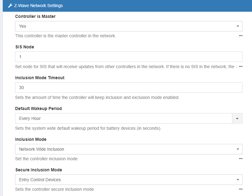

In your controller Thing settings, what do you have for Z-Wave Network Settings> Secure Inclusion Mode? This is best set to Entry Control Devices. Set the zwave binding to DEBUG and tail your openhab.log file during inclusion and while waiting for the device to initialize. Sometimes it helps to restart OH. Have you tried excluding and then hard resetting the lock? After secure inclusion, just wait with it in the Inbox.

Just set inclusion mode to Entry Control Devices. It was set to not use security.

Oh yes, this is a great point too. I have this working and here’s the controller config in Habmin.

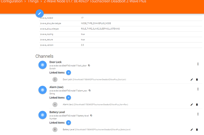

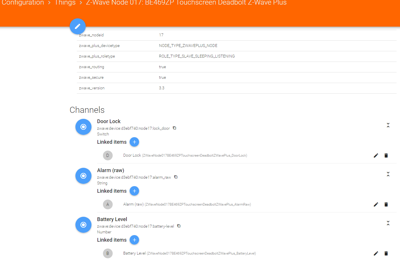

Well I’ll be! Sure enough .. tried to do an inclusion after changing the Secure Inclusion Mode.. worked fine. Thanks for helping me out! I was going crazy.. That might have been the last thing I would have checked too. I left it installed, pretty far away from the controller and was discovered fine. I did worry that it wouldn’t update the status of the lock based on manual locking as some of the older ones were reported. But seems fine. So I have 3 channels - Door Lock, Alarm(raw) and Battery Level.

Maybe mine is missing something. Should I see more than these 3 channels? I don’t see User Codes in PaperUI under the thing’s configuration.

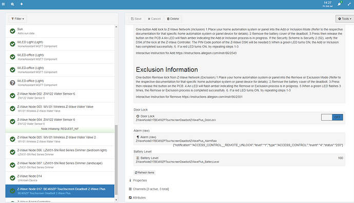

@5iver so that’s where I looked in HABmin but figured I was missing something. Is it supposed to come as channels for user codes? I see 3 channels and nothing on user codes in there. Yours looks like that?

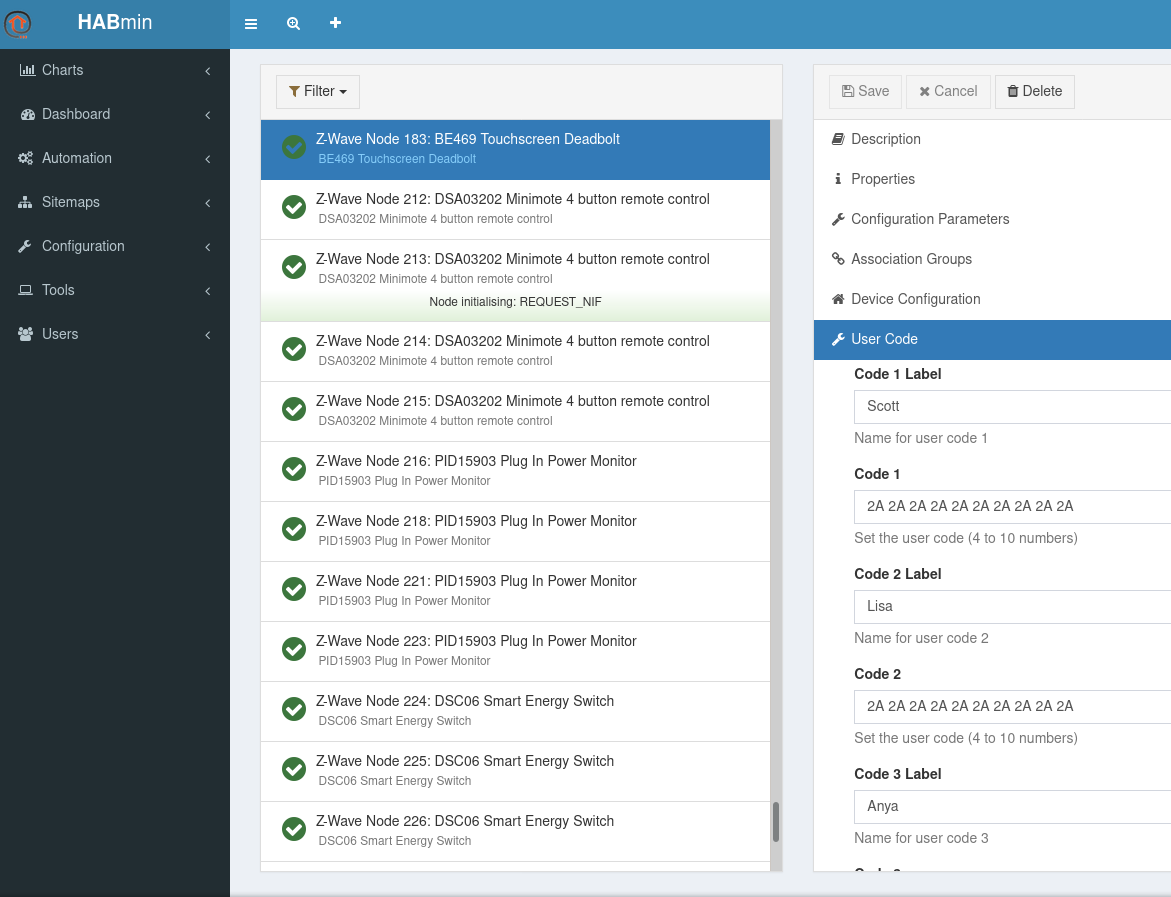

I have BE469s and they look like…

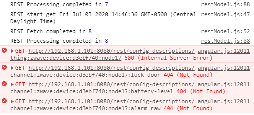

Which OS and browser are you using? Do you see any errors when you turn on the developer console in your browser (usually f12) and select the Thing for your lock?
Oh yea definitely missing that. I’m in Chrome. and definitely seeing some errors:
Could you try Firefox?
