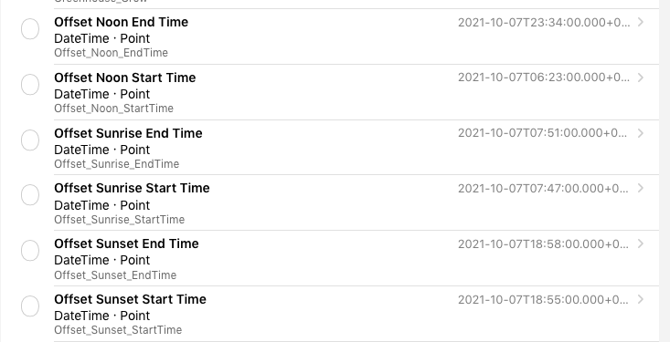

And after restarting openhab, I can confirm this changes the event start and end times in the openhab.log.
So we’re all good, right?
sort of. If I don’t set the dateTime offset for noon,
//      dateTime offset
                Type start : noon#start [
                        offset=-420
                Type end : noon#end [
                        offset=420
then the notice saying it’s 420 minutes prior to noon / noon was 420 minutes ago, appears in the logs, AT NOON! not at 420 minutes before or after noon, at noon start, and a minute later at noon end.
So this is why I set a datetime offset.

It triggers noon at 13:24 even though I set an offset of 420 minutes prior and after (for start and end respectively), and for the rangeevent.

It’s weird because sunrise/sunset DO follow the required offset in the logs… and Turns OFF and ON the light. But the noon start/end does NOT turn ON and OFF the light.

as far as I understand from docs and reading the forums, DateTime offsets and RangeEvent offsets are completely independent of one another. As you can see, the time for noon start and noon end seems to be correct! in the datetime offset, so logically the same offset would be correct for the rangeevent.

EDIT - Ohhh wait, no these are nonsense. You can offset an event like noon, but not the start and end of that event individually.
                Type rangeEvent : noon#event [
                        offset=-420
There’s only one noon, so you can’t offset it both early and late.

If you’re not using the ‘regular’ noon event astro:sun:local, use that for the other offset.

Thanks for this useful reply, this took away some questions I had.
Kind of sucks that I can’t extend the range of an event, but the workaround is pretty easy, just make another offset sun.
Except for the light turning off at midnight :stuck_out_tongue: Since I started fresh with this openhab config, there’s no scripts or actions that should turn that light off.
I’ll see if it’s remedied after I fix the initial flaws in my setup. Think this’ll do it for now though!

Seem to be getting the times I want!
NoonStart.things
Thing astro:sun:NoonStart "Noon Start" @ "Address, Town"[ geolocation="##.####,#.######", interval=60, useMeteorologicalSeason="true" ] {
        Channels:
// Noon
//      dateTime offset
                        offset=-420
NoonEnd.things
Thing astro:sun:NoonEnd ""Noon Start" @ "Address, Town"[ geolocation="##.####,#.######", interval=60, useMeteorologicalSeason="true" ] {
        Channels:
// Noon
//      dateTime offset
                        offset=420
Sunrise/sunset are still in one file, which was previously posted in this topic. Just remove the Noon section and it should work.
Mark fixed.
You don’t seem to have any offset noon events at all now, unless you’ve changed rules not to use those anymore.
Strange. It seems to be working properly however.
EDIT: I went back and checked and realized I omitted the event offset earlier..
Thing astro:sun:NoonEnd "Noon End" @ "House"[ geolocation="##.#####,##.####", interval=60, useMeteorologicalSeason="true" ] {
        Channels:
// Noon
//      dateTime offset
                        offset=540
//      rangeevent offset
                        offset=540
rule "Switch On Before Sunrise"
                Channel "astro:sun:NoonStart:noon#event" triggered START
                logInfo("Astro","Noon starts in 420 minutes")
                Outlet43_Power.sendCommand(ON)
rule "Switch Off After Sunrise"
                Channel "astro:sun:offset:rise#event" triggered START
                logInfo("Astro","Sunrise ended an hour ago")
                Outlet43_Power.sendCommand(OFF)
rule "Switch On Before Sunset"
                Channel "astro:sun:offset:set#event" triggered START
                logInfo("Astro","Sunset starts in 60 minutes")
rule "Switch Off After Sunset"
                Channel "astro:sun:NoonEnd:noon#event" triggered END
                logInfo("Astro","it's 420 minutes after noon")
openhab.log
2021-10-08 23:01:02.544 [INFO ] [e.automation.internal.RuleEngineImpl] - Rule engine started.
2021-10-08 23:01:03.295 [INFO ] [openhab.core.model.script.greenhouse] - Pump off!
2021-10-08 23:01:06.166 [INFO ] [ab.ui.habpanel.internal.HABPanelTile] - Started HABPanel at /habpanel
2021-10-09 06:22:00.596 [INFO ] [org.openhab.core.model.script.Astro ] - Noon starts in 420 minutes
2021-10-09 08:51:00.015 [INFO ] [org.openhab.core.model.script.Astro ] - Sunrise ended an hour ago
2021-10-09 11:00:00.480 [INFO ] [openhab.core.model.script.greenhouse] - Pump on!
2021-10-09 11:01:00.563 [INFO ] [openhab.core.model.script.greenhouse] - Pump off!
2021-10-09 17:50:00.018 [INFO ] [org.openhab.core.model.script.Astro ] - Sunset starts in 60 minutes
2021-10-09 20:23:00.020 [INFO ] [org.openhab.core.model.script.Astro ] - it's 420 minutes after noon
[2021-10-10 06:22:00.020 [INFO ] [org.openhab.core.model.script.Astro ] - Noon starts in 420 minutes
2021-10-10 08:52:00.018 [INFO ] [org.openhab.core.model.script.Astro ] - Sunrise ended an hour ago
2021-10-10 17:48:00.013 [INFO ] [org.openhab.core.model.script.Astro ] - Sunset starts in 60 minutes
2021-10-10 20:23:00.017 [INFO ] [org.openhab.core.model.script.Astro ] - it's 420 minutes after noon
