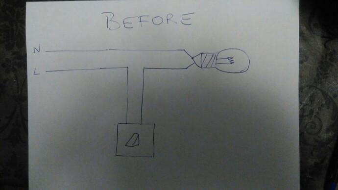

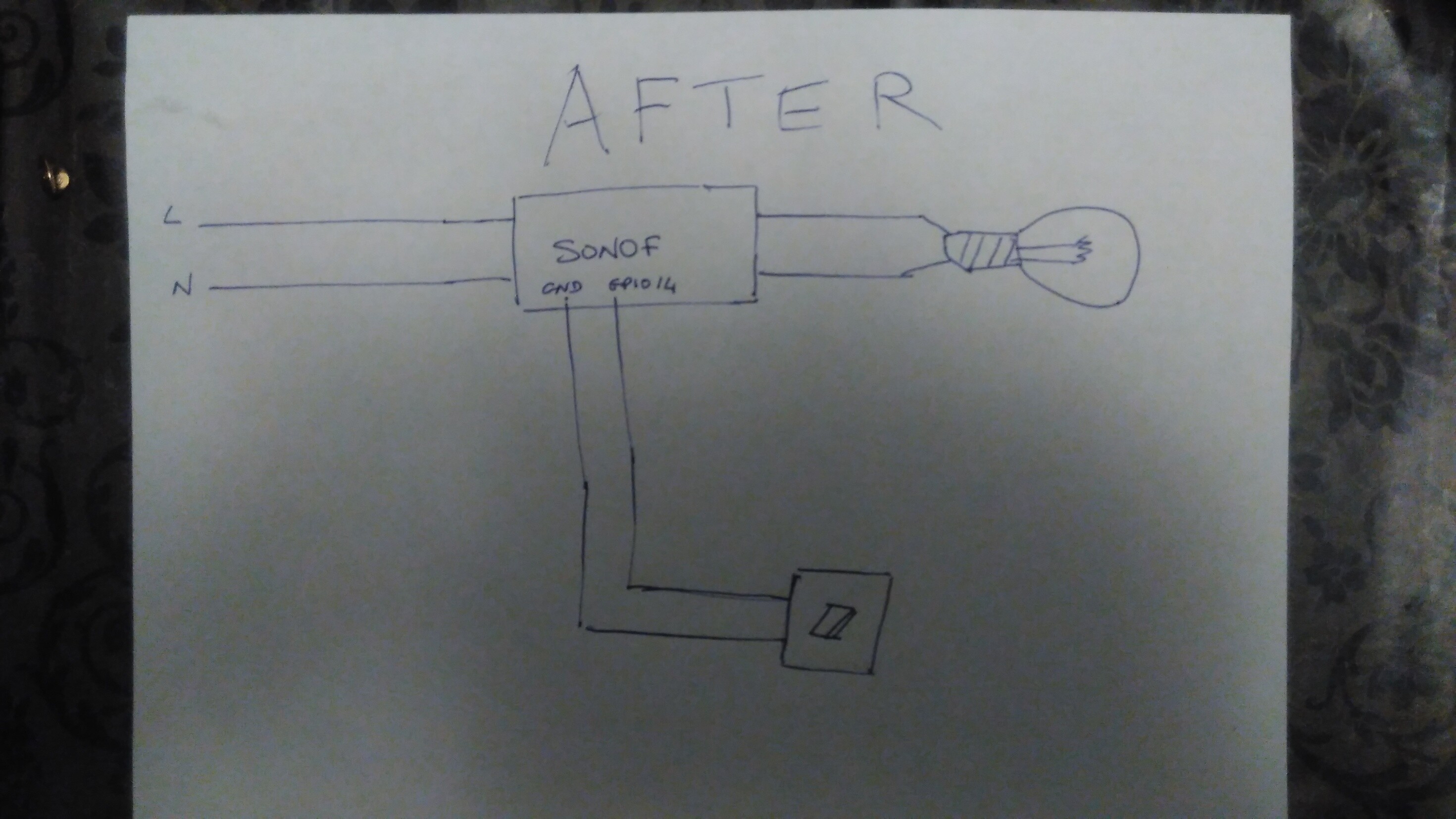

Change your wiring and have the ceiling lamp sonoff always powered. That’s what I do.
Before:
After:
