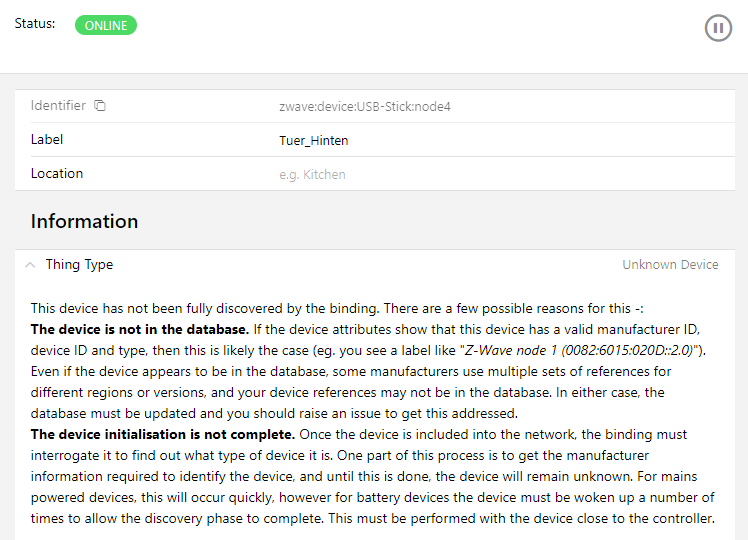

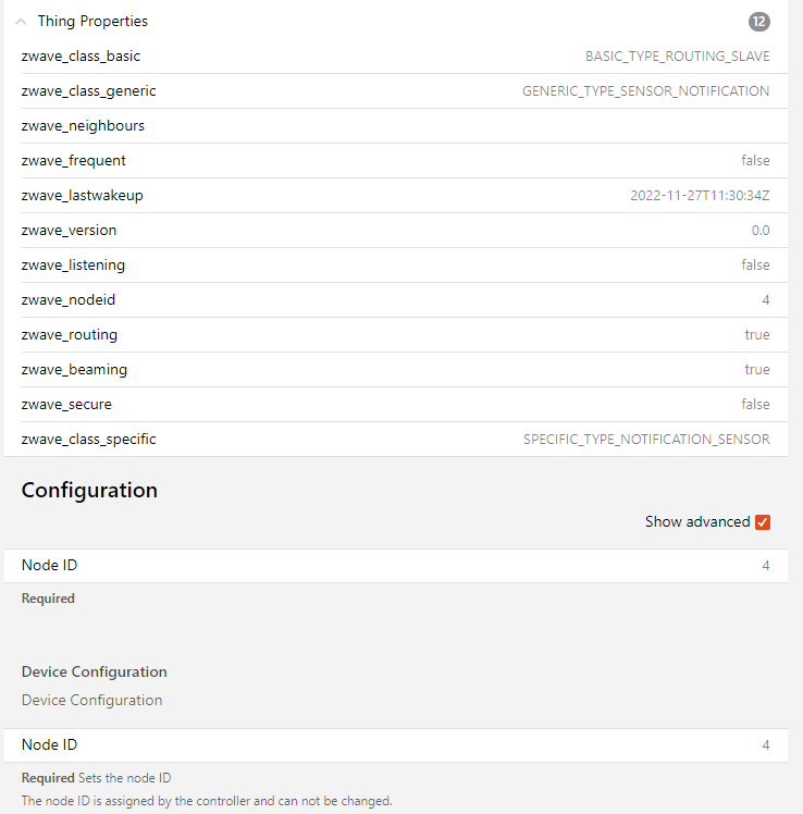

  1. On the UI page for the device, properties drop down, what are the device ID and Type. Both should be “4”. If not what are they?
  2. Also on the UI page for the device at the bottom, are there five lines? If not use the magnet to try to wake the device. These devices can be tough to fully include
Hi apella12,
thanks to get in touch.
Jup ID is 4
What to you suggest me to do?

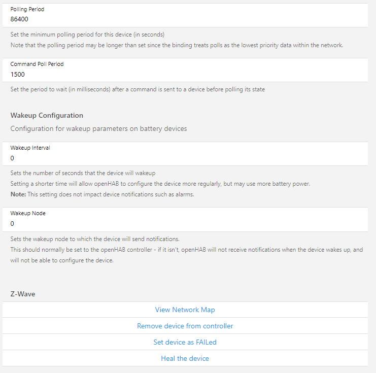

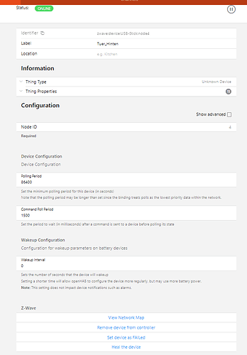

Use the drop down to look at thing properties first, your pictures do not show what I’m looking for.

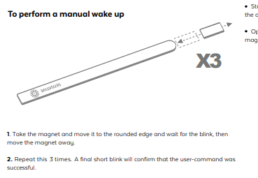

then use the magnet to wake the device as per the manual
Thats all I have.

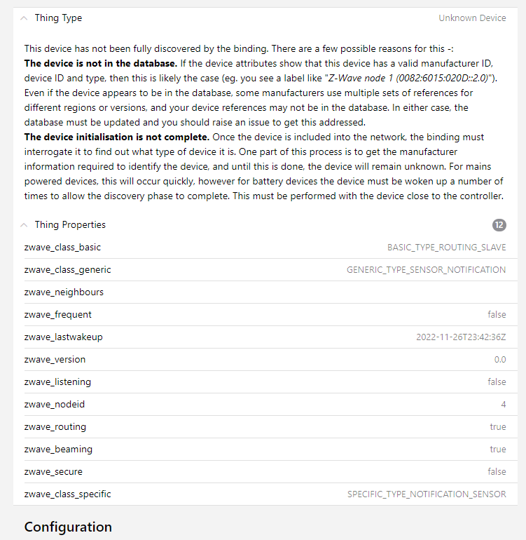

Done the wake up move. One thing property comes up more. From 11 to 12. Does this take more time?
I’m afraid so. Keep trying to wake until you get five lines. Do the wake as close to the zstick as possible.

Hm.. tried a few times the wake up move - still 12 properties available. zstick is in front of me.

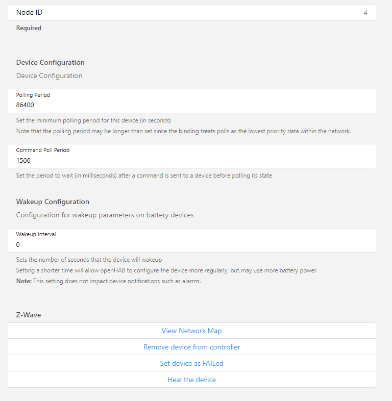

No I can’t find the Z-Wave node 1 entry. I just can see it under the thing type info.
Thats all I can see at the UI:

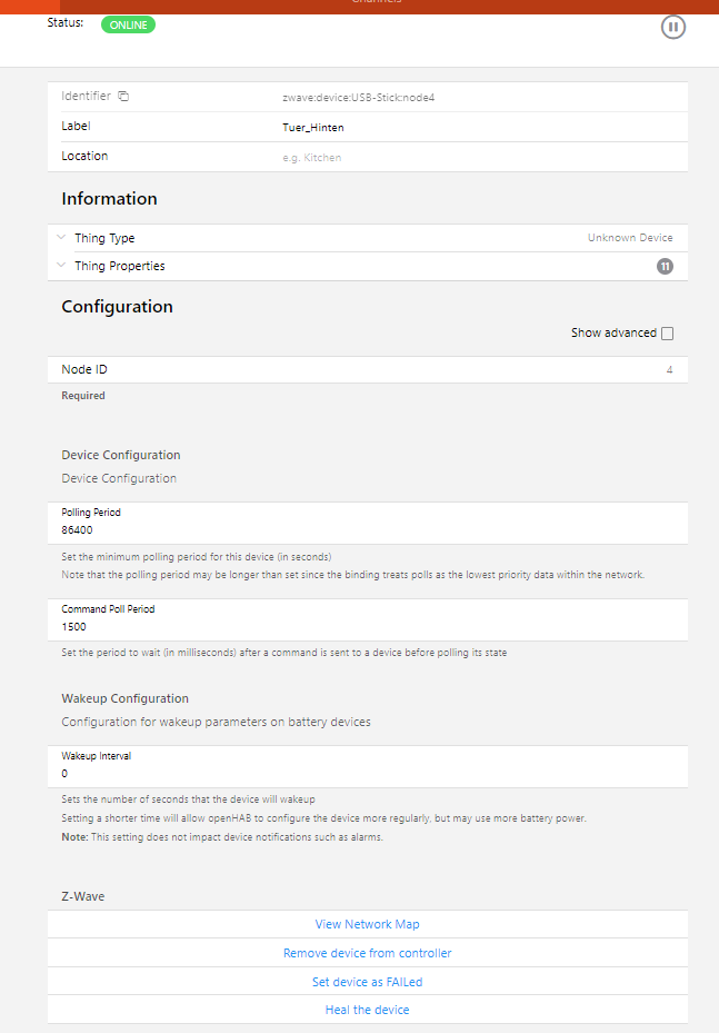

  3. What does the controller UI page look like (mark advanced tab before making picture)?

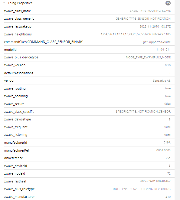

There were some improvement in zwave battery device initialization in OH3.3. I have some of these devices. Before was as described in earlier post; After no problem
@apella12 Thanks for the hint - after the improvement I could initialize my 2 devices w/o a problem today!
