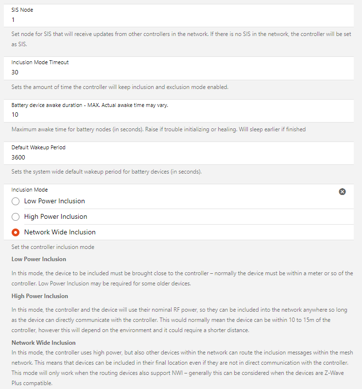

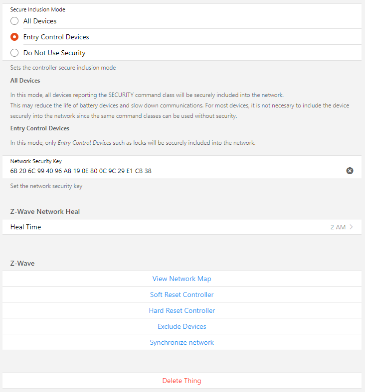

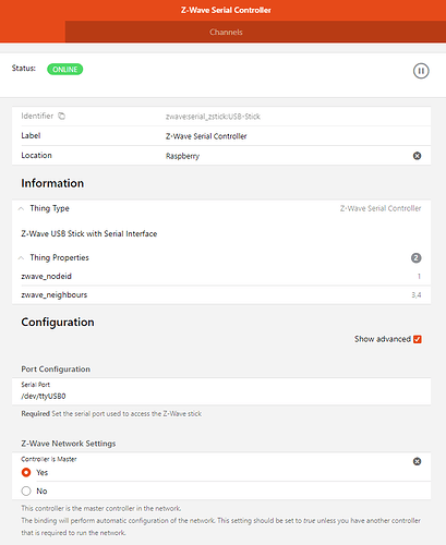

  3. What does the controller UI page look like (mark advanced tab before making picture)?
