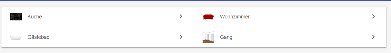

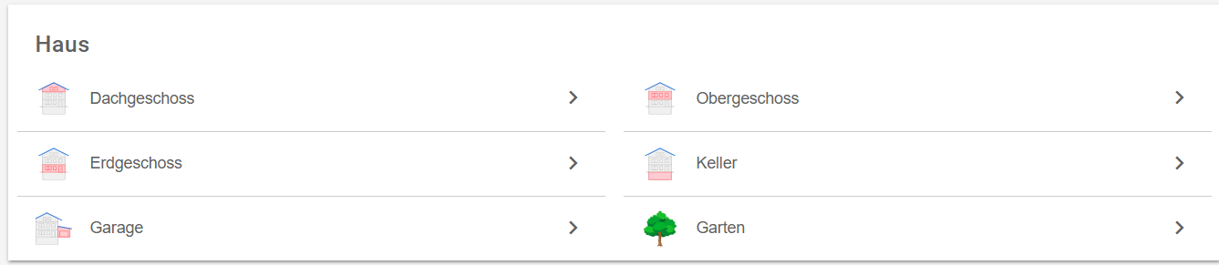

In the sitemap I only add the groups
Frame label=“Haus” {
Group item=gAT label=“Dachgeschoss” icon=“attic”
Group item=gFF label=“Obergeschoss” icon=“firstfloor”
Group item=gGF label=“Erdgeschoss” icon=“groundfloor”
Group item=gCE label=“Keller” icon=“cellar”
Group item=gGA label=“Garage” icon=“garage”
Group item=gGT label=“Garten” icon=“garden”

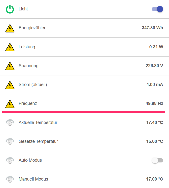

But at the moment I have the problem to separate the items in a group. I like separate the items like in the screenshot.
How can I do that, without to change my hole groups.

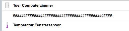

I use a string item with content ‘####################################’ as a seperator for different groups

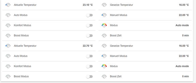

The problem is that you can’t insert a string item or sitemap frame in the middle of a sitemap group.
But how can I create something like that?
and then
The hard way
Text item=GardenGroup {
     Text item=windspeed
     Text item=subGroupGreenhouse (
          Text item=temperature
           Switch item=heater
      Switch item=sprinkler [valuecolor=[ON="red",OFF="blue"]]
Thank you. With you hint I get a solution for me.
