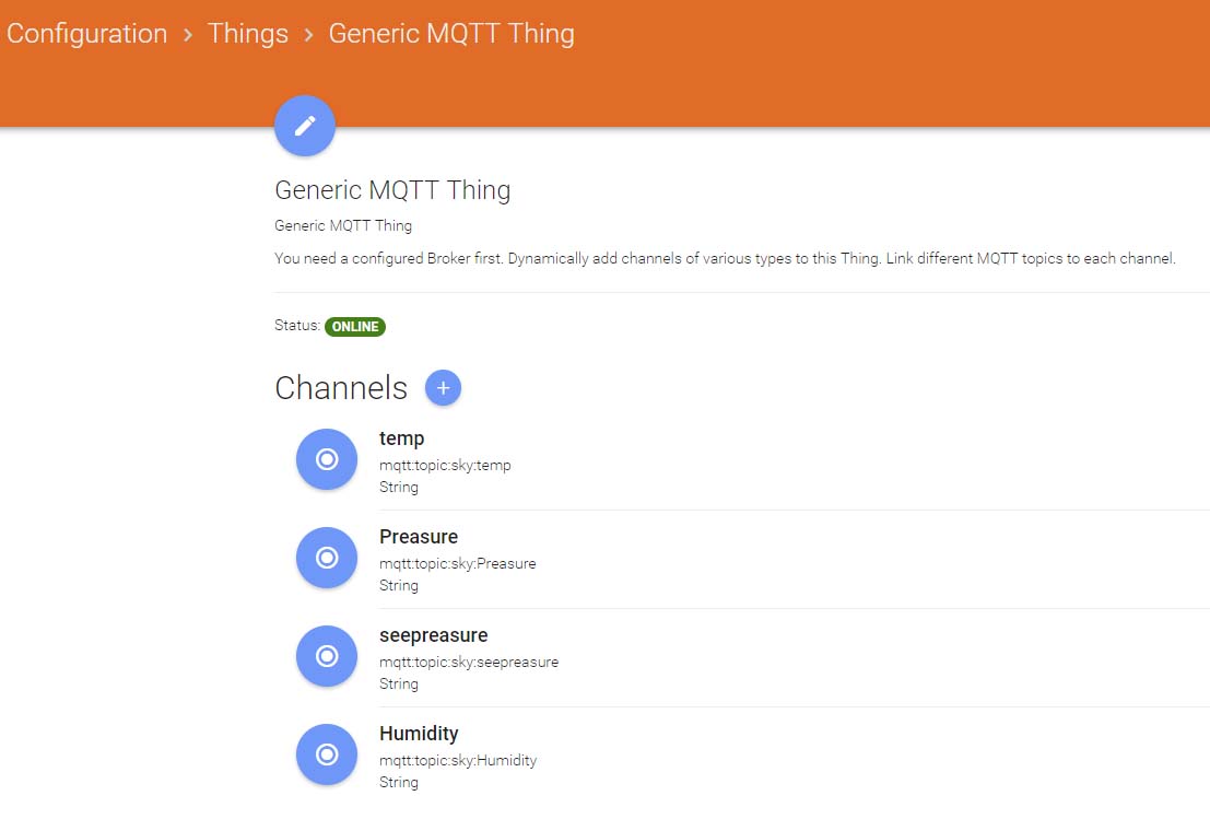

John, I have connected the BME 280 on esp with Tasmota to openHab via MQTT. If You wish I can show you config screenshots.

Here You go :slight_smile:

Esp:
Paper UI:
Rafal
