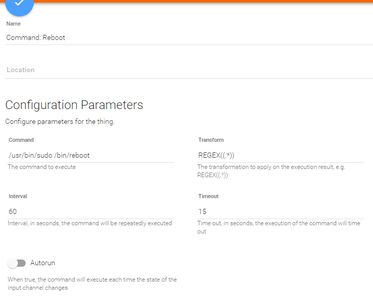

I’m really struggling to get this working :frowning: Please can someone nudge me in the right direction?
I’ve read the docs regarding the fact that the user “openhab” needs to be able to run the shutdown comamand in order for this to work. I feel this is where I’m going wrong. As the following does not work:
sudo -u openhab reboot
Here are the steps I have taken which have been unsuccessful:
  1. Log into my Pi and add the following to /etc/sudoers.d/common_users
openhab ALL = NOPASSWD: /sbin/reboot, /sbin/shutdown
  1. Add the Exec Binding Add RegEx Transformation Service
  2. Added Thing in Paper UI:
2018-04-05%2014_03_51-Paper%20UI
.items
Switch Reboot "Reboot" { channel="exec:command:6dba3517:run" }
.sitemap
Switch item=Reboot mappings=[OFF="Off", ON="On"]
Any help would be much appreciated thanks.

Be aware that the path to reboot is /sbin/reboot, not /bin/reboot
Woohoo, it is working now. I noticed as I left it at a 60 second interval by mistake and my Pi kept restarting. :grin:
Thanks for your help :+1:
Thanks for this. Working like a charm, sortoff. Problem is that after I used it, it keeps on shutting down.
From what I could see it seems the switch is initialized from Null to On thus triggering the script again.
I’ve added autoupdate=“false” to the switch item but this doesn’t seem to have helped.
Will initializing the switch within the startup rules prevent this?
