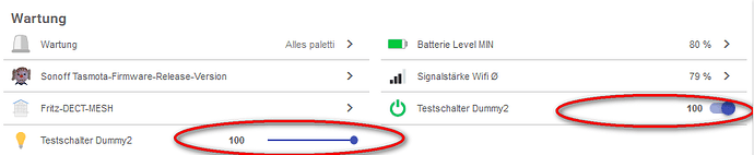

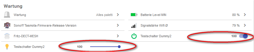

i tried the following:
item:
Dimmer			Dummy2	"Testschalter Dummy2 [%s]" (gPower)
sitemap:
    Switch item=Dummy2
    Default item=Dummy2
Rule:
rule "Test Dummy2"
    Item Dummy2 received command
    logInfo("Dummy2.rules", "Switch: " + Dummy2 + " Command: " + receivedCommand)
and the logger says, when dimming or switching:
2018-11-09 00:55:12.496 [INFO ] [.smarthome.model.script.Dummy2.rules] - Switch: Dummy2 (Type=DimmerItem, State=33, Label=Testschalter Dummy2, Category=null, Groups=[gPower]) Command: 33
2018-11-09 00:56:26.475 [INFO ] [.smarthome.model.script.Dummy2.rules] - Switch: Dummy2 (Type=DimmerItem, State=61, Label=Testschalter Dummy2, Category=null, Groups=[gPower]) Command: 61
2018-11-09 00:56:28.926 [INFO ] [.smarthome.model.script.Dummy2.rules] - Switch: Dummy2 (Type=DimmerItem, State=16, Label=Testschalter Dummy2, Category=null, Groups=[gPower]) Command: 16
2018-11-09 00:56:59.822 [INFO ] [.smarthome.model.script.Dummy2.rules] - Switch: Dummy2 (Type=DimmerItem, State=0, Label=Testschalter Dummy2, Category=null, Groups=[gPower]) Command: OFF
2018-11-09 00:57:01.539 [INFO ] [.smarthome.model.script.Dummy2.rules] - Switch: Dummy2 (Type=DimmerItem, State=100, Label=Testschalter Dummy2, Category=null, Groups=[gPower]) Command: ON
If your using the dimmer you will get a value as receivedCommand and if your using the switch you will get ON or OFF, but the state will allways be between 0 - 100.
So try an “if-function” in the rule to check the receivedCommand, if it’s ON/OFF or value.
Could this be a possibility for a solution?
