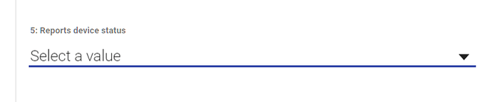

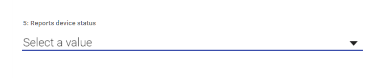

Have you tried setting the association group 5 to Controller?
@OMR I can only guess, but this looks like the new experimental Rules! The OP was using standard rules Files!
@wizzo try removing the 'singles quotes around the item name in the when part of the rules. Additionally you can add logInfo statements in the rule in order to get a feedback if the rule is started or not.
Ehh, no. It’s the Association setting for the device in PaperUI.
Looks like this in habmin:

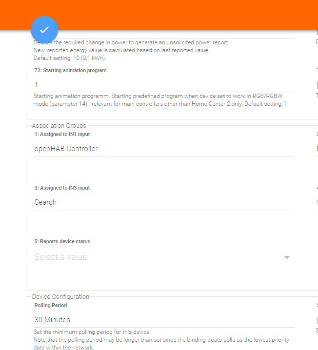

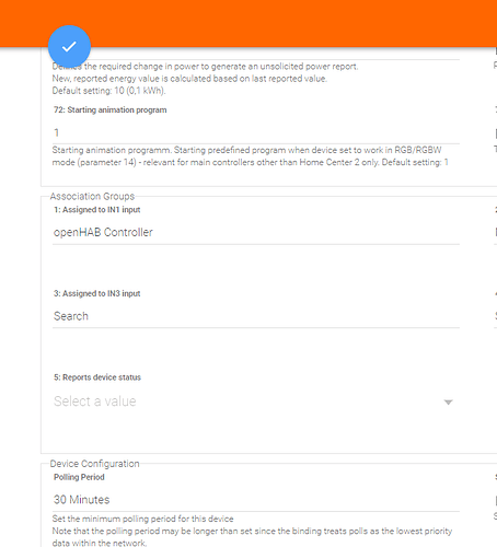

Where do I find those assoziation groups?

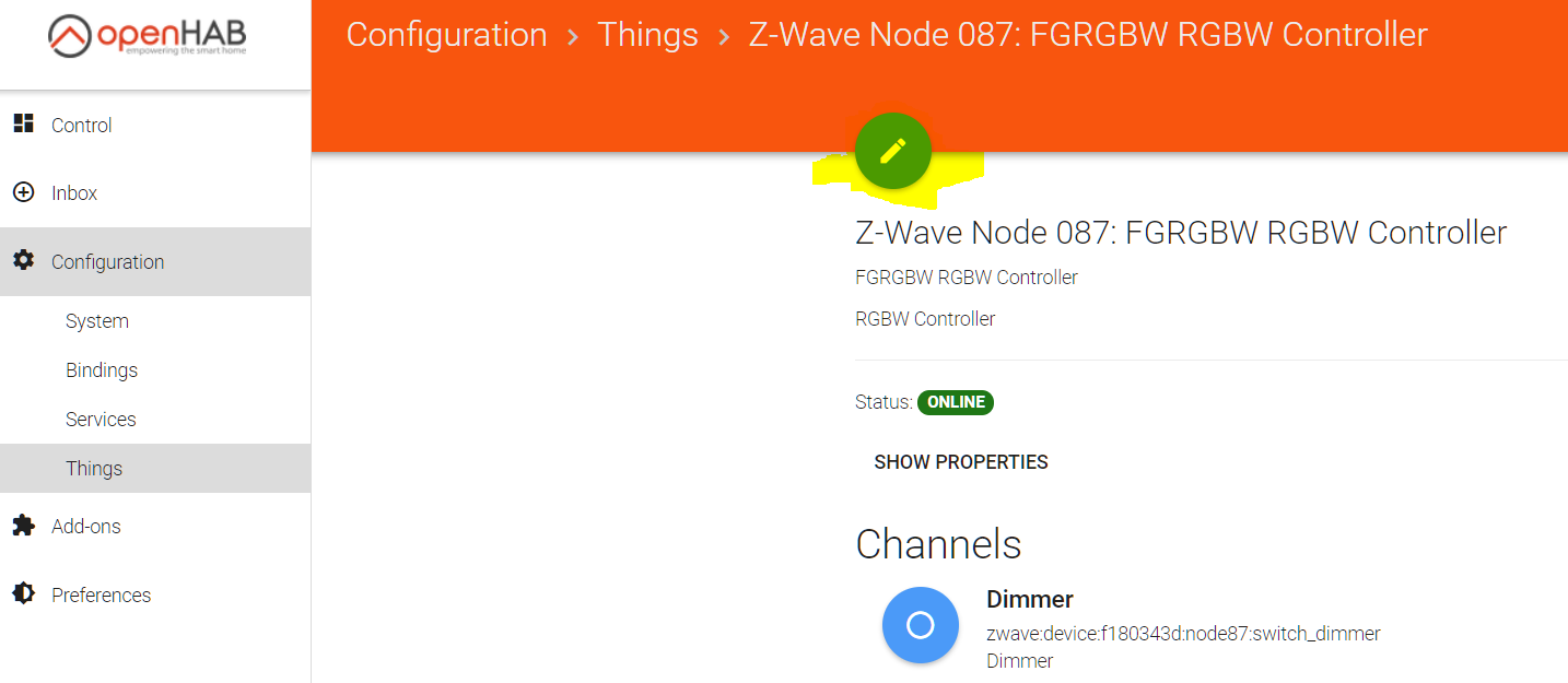

In paperUI:
Try associating Group 5 with Controller.

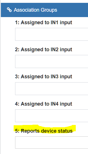

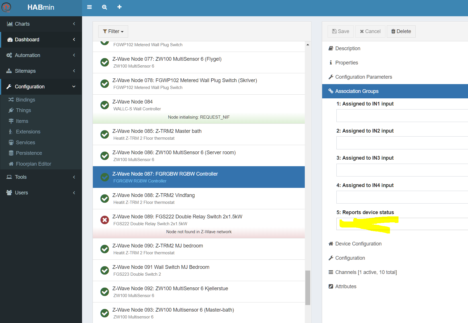

In Habmin:

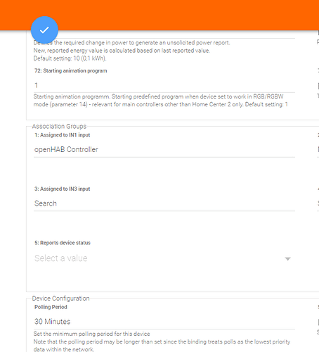

Thx a lot, that does triggger a lot mor reportings into the console (log) Is it possible to define a “state” like if somethign is chaning from 0 to >0 it is interpreted as on and if the value is changing from >0 to =0 it is hjandled as off?
Hi it does not save the reporting setting. :frowning:
Do I need to select somethign for the IN 1

Known bug in paperUI. Just try again until it sticks.
If you don’t need reports from the 1-4 inputs, you are fine.
If you do, search the forum for detailed instructions.

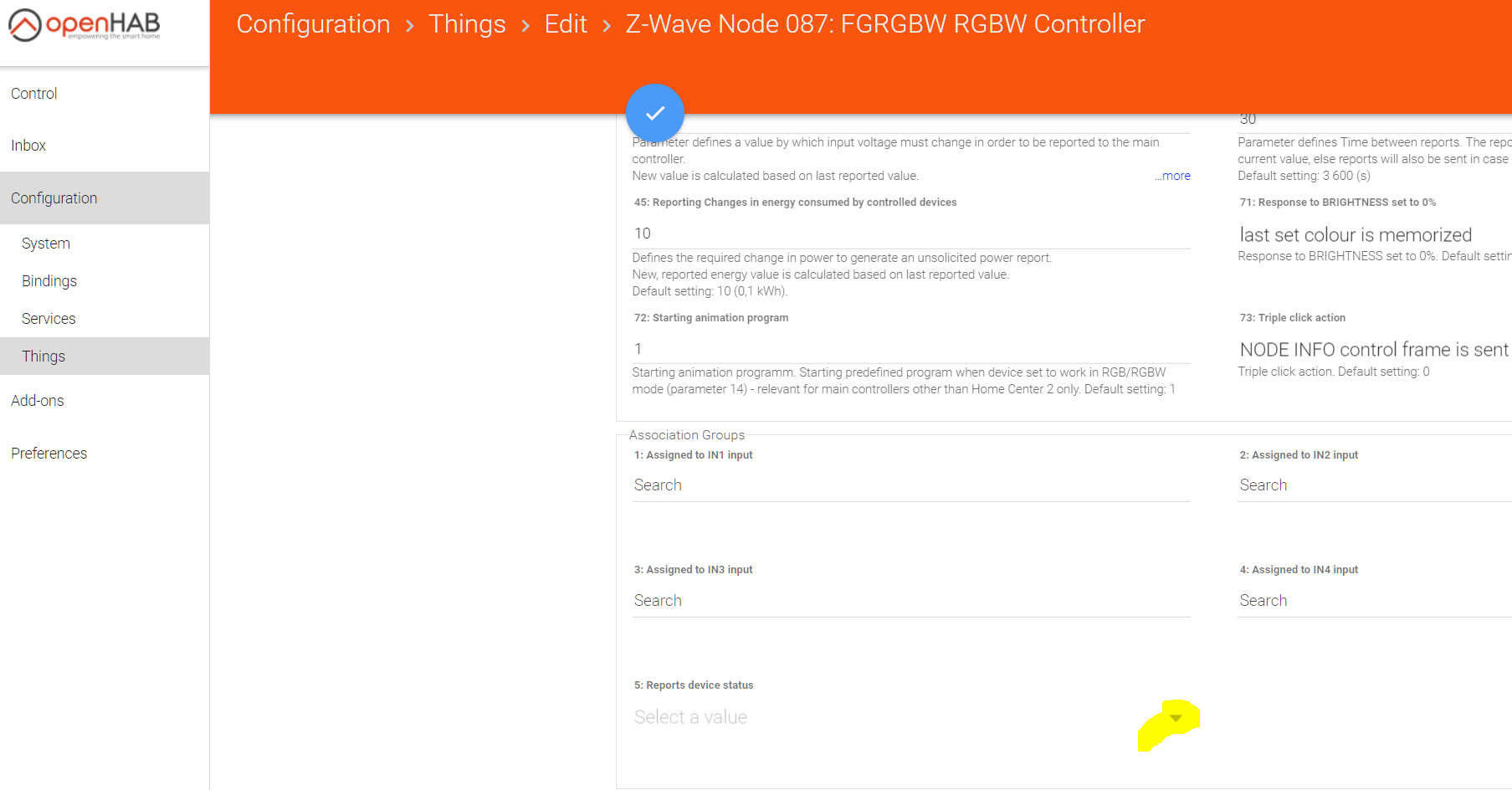

I believe the “wall switch” is the IN1 so it should report to z-wave controller as well I assume
my HABmin does not save anythign either do I need to change something?
Check:
found the stuff in habmin..lets see if that does any difference
