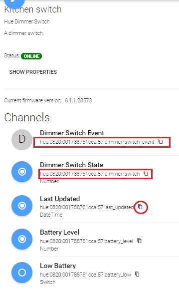

                               **Adding Hue Dimmer Switches to OH**
  1. Add the dimmer switch too openhab using paperUI creating the thing only
  2. create the items in text files (copy and edit this too the items folder save as hue.items edit the channels at the end of the items too match the ones listed in the thing on paperUI
Number KitSwitchWhat "Kitchen Switch Button [%s]"                                                {channel="hue:0820:001788781cca:57:dimmer_switch" }
DateTime KitSwitchWhen "Kitchen Switch When [%s]"                                                 {channel="hue:0820:001788781cca:57:last_updated" }
Number KitSwitchBattery "Kitchen Switch Battery [%.0f %%]"              {channel="hue:0820:001788781cca:57:battery_level"}
the channels at the end of the item files are listed on the thing on paperUI marked in a square you can just copy them using copy marked with a circle saves alot of typing and mistakes
