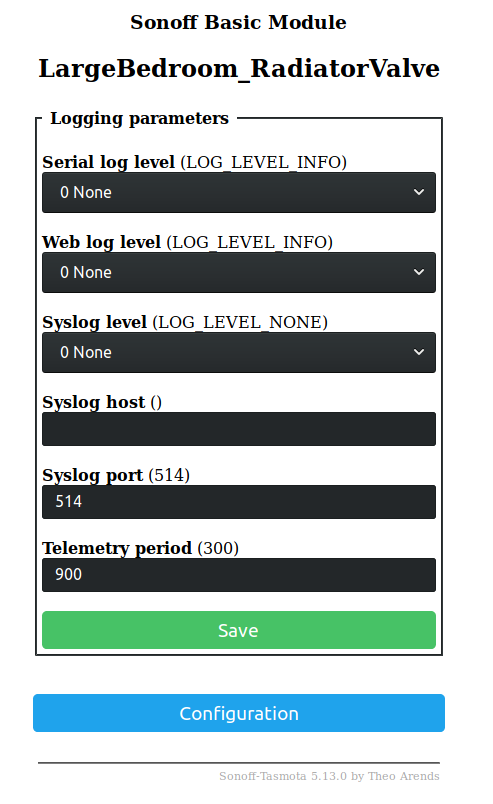

It’s also good practice to turn off all the logging in the sonoff console.
