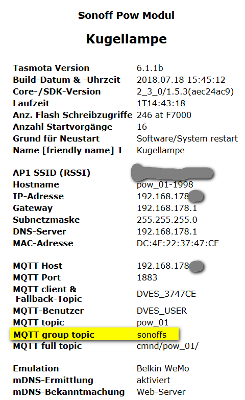

and the result looks like this:
As i’m a newbie and do not understand Java and programming, i’m wondering how the rule works.
My first question:
From where does the rule know which are the “sonoffs” items (group topic) in the array ? I didn’t declared them anywhere. Is there a mechanism in openHAB to store it an can one see them with system tools ?
