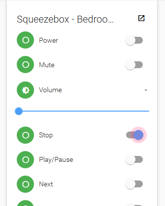

Here the Player Control in PaperUI

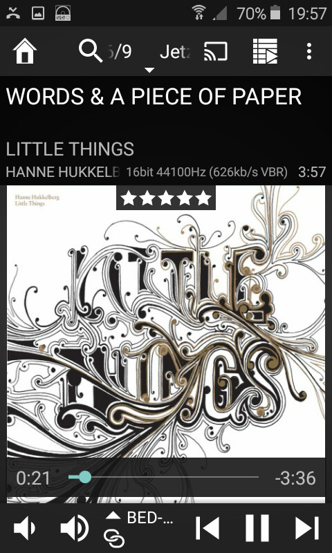

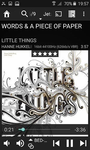

…and a screenshot from my smartphone taken at the same time!! …all items are linked to the channels in PaperUI …also tried changing the server id which was the mac without : into something else…

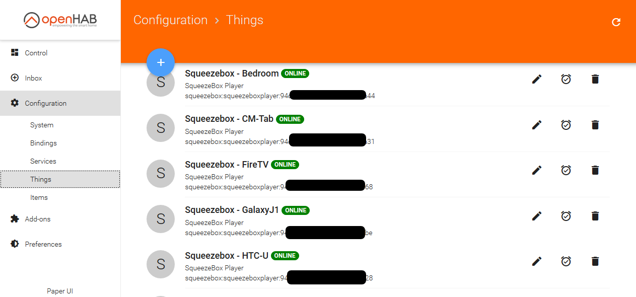

So, in Paper UI, when you select a squeezebox player thing, you see the channels with the icons that have the little dot in the center. Like this?

yes this is right…
yes the dots are shown… the same items file with changes to the server id was working with my PaperUI added things but not when I add them with my config files.

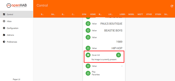

I still get no cover art - your changes seemed to be merged already?!??
Same issue here again! Can you please confirm that the update is merged already?
It was merged 10 days ago.
