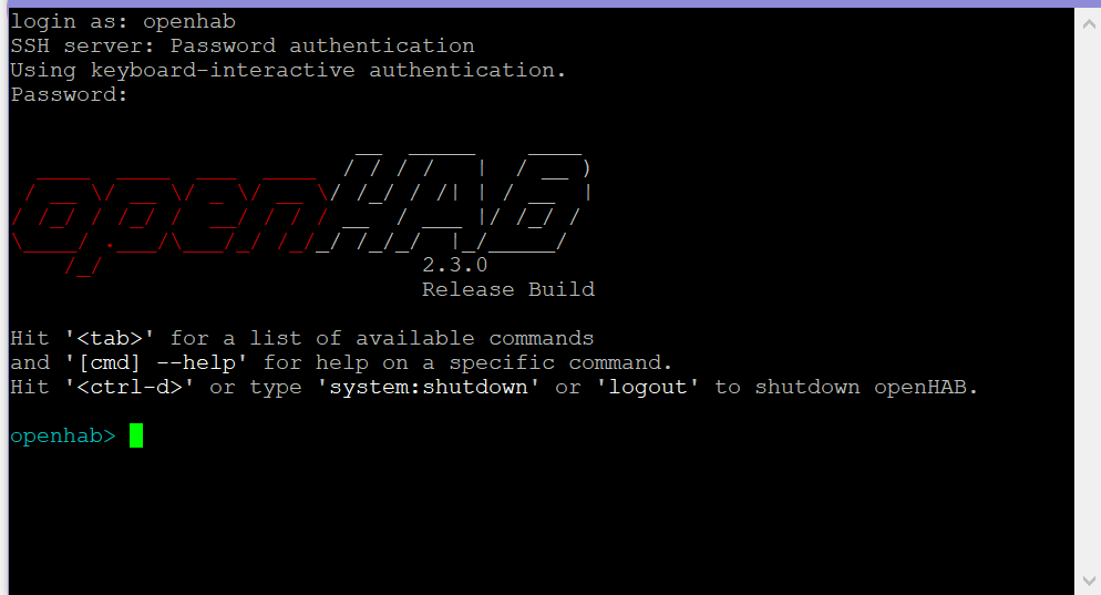

This is my starting screen after logging in. Looks like a little bit different.
This screen shows when you are on Karaff! You should use “sudo openhabain-config” before entering “ssh -p 8101 openhab@localhost” !!
OK, maybe that’s the issue…
I’m not working directly on the pi, instead I’m using putty to get remote access and this screen appears after logging in. What do I have to do to get to your starting point?

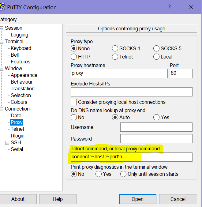

Is this the right place? PuttyConnection
No, after connecting with putty. You should get a window with “login in:” followed by the question for the password. After that is completed you can enter the above!
I used to do this a few times. But after executing sudo with the default password I’ll get an access denied.
Am I doing the same process like you mentioned?AccessDenied
If you are getting this display ( which is the Karaf console) directly from putty you are doing (somehow) two steps in one move.
In there I would use “logout” to leave the console(not sure if the whole window would close in your case).

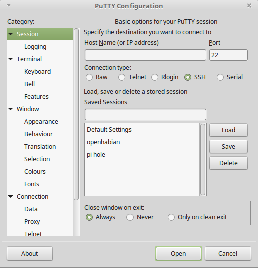

Have you tried to access the terminal without proxy, just a normal session? Here’s an example where you enter your IP or host name (of openhab server) with port 22 and select SSH.
Screenshot%20at%202018-08-26%2007-09-27
@H102 it works and now I’ve got access to the openHABian Configuration Tool!.
