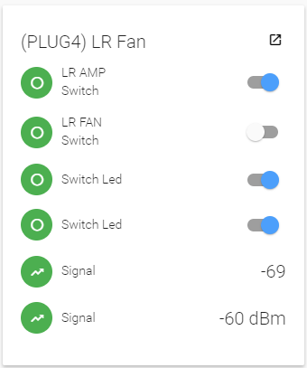

both my amplifier and my fan have smart sockets attached when i change the state off the smart socket connected too the amplifier it also sends the same command too the fan socket
its happening if sending the command using any UI or triggered by a rule

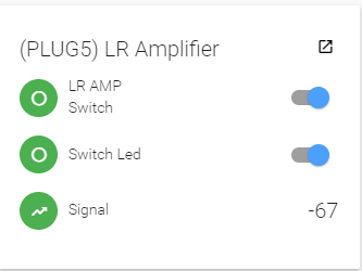

and looking in paperui controll section there is a strange looking pannel

Moving item Plug 5 LR AMP too a separate text items file cleaned up the problem tile on paperUI control and that seemed to have stopped the weird behavior
I have moved it back too the original file and it seems to be ok now any ideas what caused that ?
