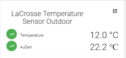

When I look at the Control in Paper UI it shows two values, the one created automatically through Paper UI (Temperature)and the one I’ve defined in my items file (Außen). The system generated item stays on the correct value while the one from the items file alternates between correct value and value from the living room sensor.
Any ideas what is happening here?

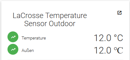

Ok, restarted openHAB on the diskstation and the problem seems to be gone.:frowning:
“Have you tried turning it off and on again?” … should have tried that earlier. Anyway, maybe the description of the issue is usefull for someone. :grinning:
