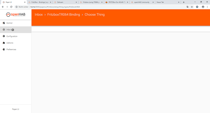

I have the FritzBox TR064 Binding installed.
Then I have made a Service file called fritzboxtr064.cfg.
There I tipped following text:
  url: https://420.420.420.420:49443
  pass: <Passwort>
…But my Thing item is not finding:
as i know there is no discovery for this binding. You have to create the needed items in an .items file manually.
See
Just copy/paste the items
That binding is a version 1 binding, there are no Things and Channels.
Configuration is done through items and cfg files.
