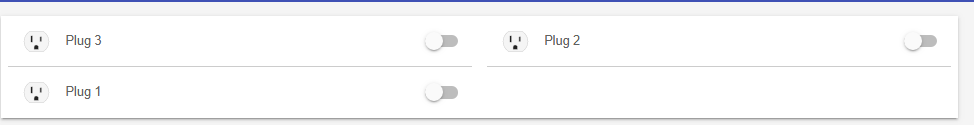

You mean like this?
I am interested in how the BasicUI determines switches. Here is the binary switch on my motion sensor.
Yes, this is what I mean. My “Switch” however looks like your “Papillon Motion” instead.
