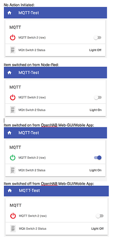

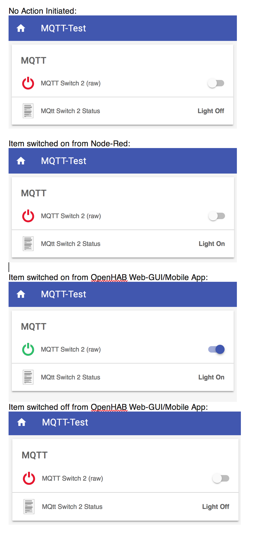

I made good progress in getting my MQTT working on OpenHAB on RPi3 and have a few ESP8266’s communicating and operating well.
I did however reach a stumbling block when it comes to the updating of my Switches in the GUI should the status of the item be changed from another external source (Node-RED etc.)
This ver simple example should explain what I am facing:
My MQtt Switch 2 Status will update perfectly when the device status changed, whether from using the “MQTT Switch 2” or external MQTT publisher but my switch status would only change when the item state has been changed within OpenHAB by clicking on it.
