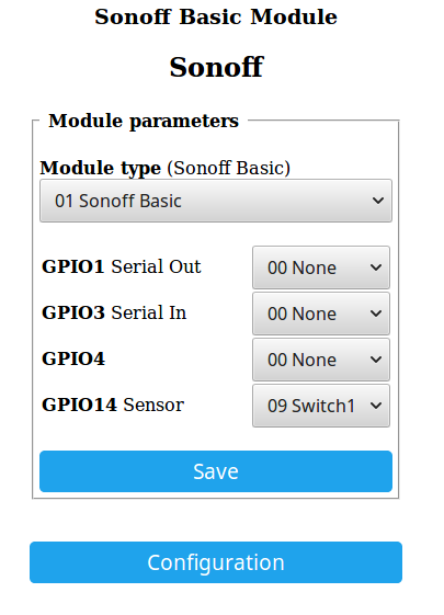

Here’s a pic of how the sonoff is configured for using GPIO 14 and wall switch.
Hope this helps.
