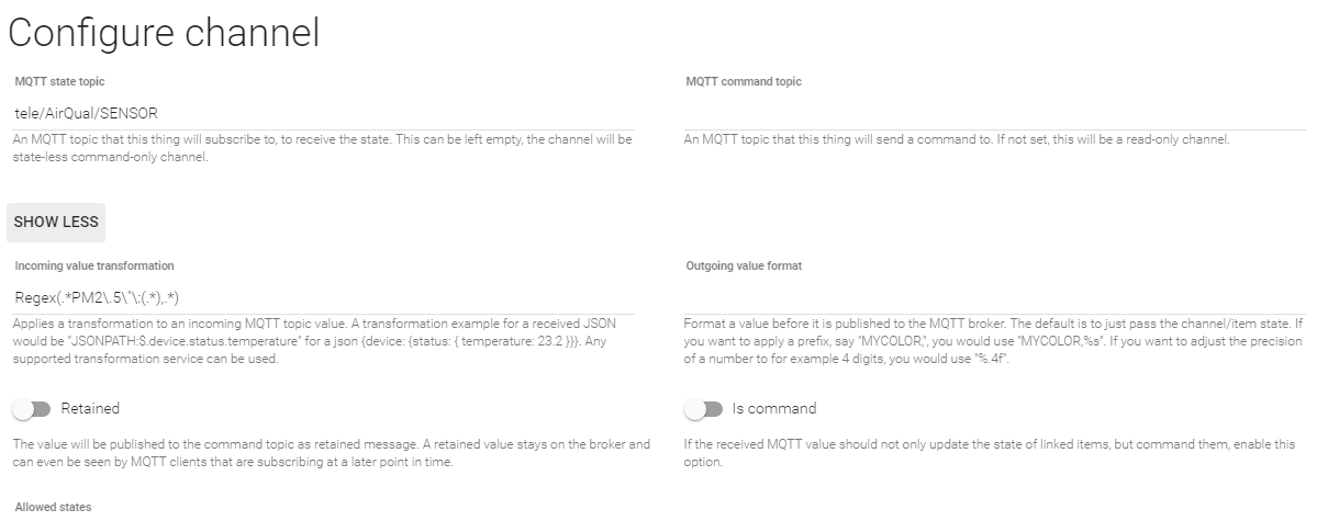

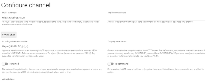

Config:
the sensor is connected via serial into a sonoff with Tasmota.
MQTT.fx is reporting the following:
tele/AirQual/SENSOR
{“Time”:“2019-05-15T18:37:21”,“SDS0X1”:{“PM2.5”:2.3,“PM10”:6.3}}
The Thing is set up as generic MQTT and the channel is set up as TEXT (and I’ve tried Number) and as follows:
(This works fine with JSONPATH:$.SDS0X1.PM10)
If i remove the transformation i get the full results in the item.
However if i use JSONPATH:$.SDS0X1.PM2.5 or Regex(.PM2.5":(.),.) or Regex(.PM2.5":(.),.) it fails.
John
If you are using the MQTT binding, you have to use the proper syntax for transforms.
REGEX:.*PM2\.5\"\:(.*),.*
The syntax for MQTT2 is different from what other bindings use.
That : still might cause some problems too. If it does, replace the \: with . and it should still work.
Thanks very much, its working fine now. as per the solution above. I didn’t know MQTT 2 Binding affects Regex as well. Some more reading needed!
