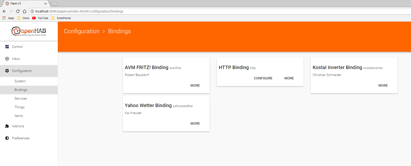

I Install the TCP/UDP Binding but I can’t find it in the Configuration → Bindings settings (see in the picture)
Probably it is because its an binding for openHAB1

Correct.
No, only for 2.x bindings.
But you need to configure a tcp.cfg file, please read the docs and tell us the point where you are stucked:
