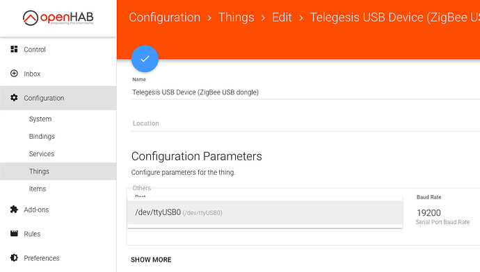

Hi Chris,
When I want to edit the thing (Telegesis USB in this case) I want to select the port wich one it should use to communicate:
As you can see, I only can select the /dev/ttyUSB0 but I made 2 aliases in the /etc/udev/rules.d/99-com.rules and I could see them with the command ls /dev/tty* but not in Openhab PaperUI
Did you add the openhab user to the dialout group?
Have you added the aliased ports to the command line when starting OH? →
EXTRA_JAVA_OPTS="-Dgnu.io.rxtx.SerialPorts=/dev/ttyUSB0:/dev/ttyS0:/dev/ttyS2:/dev/ttyACM0:/dev/ttyAMA0"
Yes I added it before
Yea I added them and rebooted, but they still won’t be selectable in the dropdown menu when editing a thing, the column with the java options look like this:
