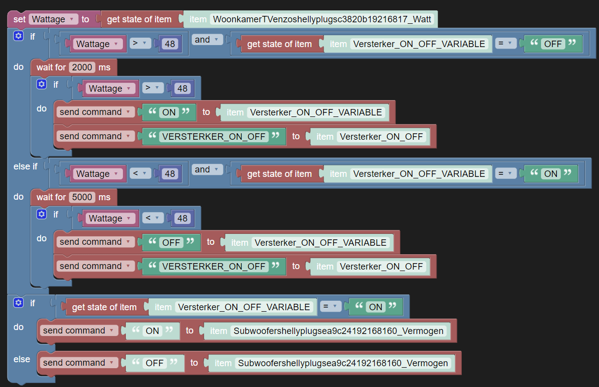

Thank you all so much for your help!
What a great community this is!
I just want to commented to @Matze0211 that Blockly doesn’t support timers but now that I updated OH3 it does, awsome.
I also tried @mgeers way and this also works.
@ubeaut, thank you for your input but your suggestion is beyond what I can understand.
@jimtng , I am looking into jruby next graveyard shift, it looks fairly straightforward.
Thanks again all.
Works like a charm, glad the OH devs made is so eas for a noob like.
Thx again for everyones time!
