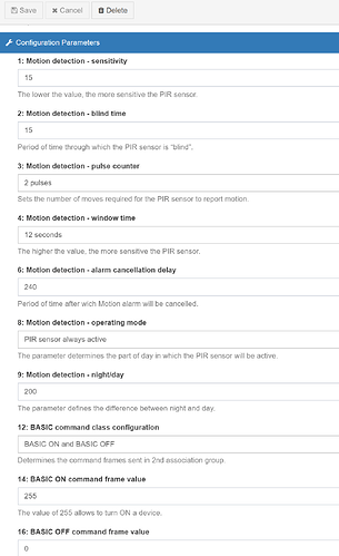

I would suggest to combine your rules and Fibaro motion sensor parameters. If you want to switch on/off any time without consideration time, light etc you do not need rules at all. Zwave devices are able to control direct each other. In my case eaxample parameter 6 is at 240 sec. It means in case of FIbaro sensor, that it sends motion signal, than it switch off after 240 sec, but if it senses motion, this timer restarts in the device itself:
If you want to consider other devices, or time of the day, rule can look like this:
