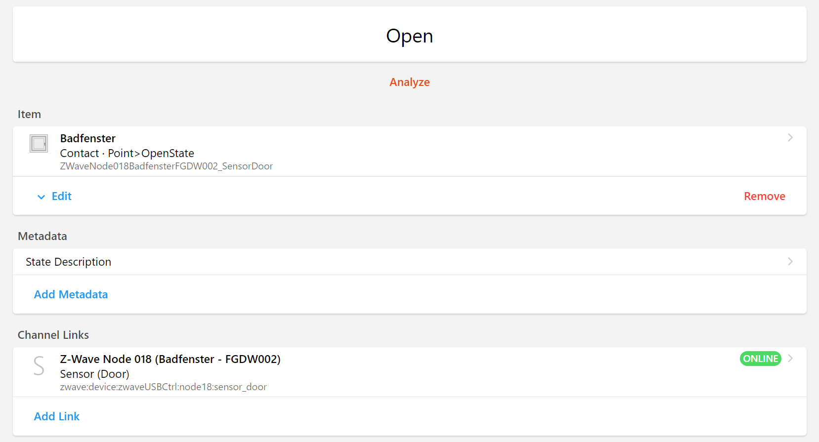

The problematic contact is a “real” contact channel of a window sensor (Fibaro).
This sensor is a equipment (window) and has a few points (OpenState, Battery, …)

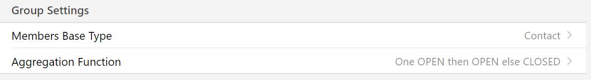

I have configured the Window equipment like this:
and:
This “Mother”-Equipment reflects the mapped state “zu”
The contact point within this equipment itself returns “Closed” in mainUI even though I have set the State description pattern the same way.
Furthermore the eventlog returns “CLOSED” if the windoe changes (uppercase).
Does anyone have an idea why this is not working as expected?

I’m going to guess that this sensor is Zwave since it’s a Fibaro. The Zwave binding will supply its own State Description to the Item behind the scenes. This can cause problems that is not related to this thread so I won’t go into it. That’s where the “Open” is coming from.
I’ve been told that this “injected” state should be overridable by setting a State Description metadata of your own (except in the case of that problem).
If I understand correctly, you have entered your own State Description Pattern but it’s not overriding what the binding has provided. Correct?
I believe in this case the binding is providing State Description Options. What happens if you move the contents of your .map file to the Options field of the State Description?
NOTE: I’ve found sometimes it takes a refresh of the browser to pick up changes to the State Description metadata.
You can confirm that by examining your Item with API Explorer.
One of the things the binding-supplied options was intended for was to supply in language as per OH base setting. But that depends on someone setting up the binding end.
I’ve an issue open in front of the AC and I have Kai’s attention but I need to confirm whether or not the stuff supplied by the binding can be overridden when the Item type is correct (we already know it doesn’t work when a Profile was used to change the Item type). There is a proposed solution but it won’t work if we can’t override it in a case like this.
That’s a Group, not any “real” contact channel of a window sensor
And it seems that works fine.
That’s a clue it is using the binding-supplied state options, not the user supplied MAP.
The raw state is CLOSED, so “Closed” must come from options.

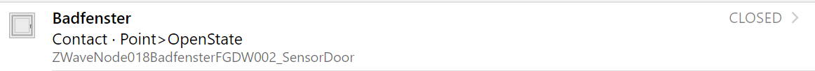

In the “Items” view the Contact shows CLOSED:
Thanks for your help.
The “hidden” Options are really confusing!
