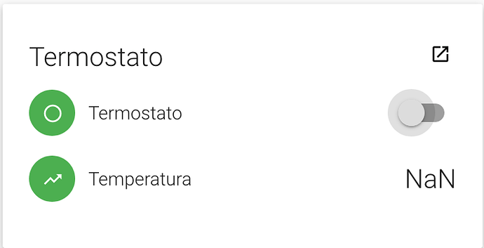

Hi all,
I installed openhabian on a R Pi 4 4GB.
Installed JSON and Javascript transformation.
I want to transform the value of tasmota temperature sensor from the Paper UI config.
Can do you help me?
What I’m wrong?
TnX to all
Jad

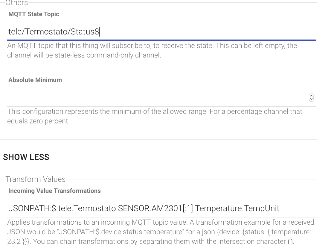

Hi all,
Can do you help me?
What I’m wrong?
TnX to all
Jad

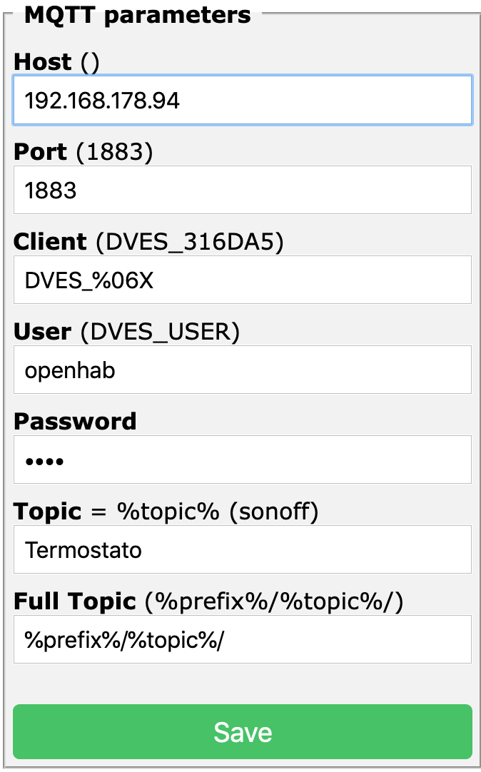

As far as I know a MQTT topic doesn’t allow whitespaces. There is a whitespace in your configuration @Jademic
Try to remove it and report please

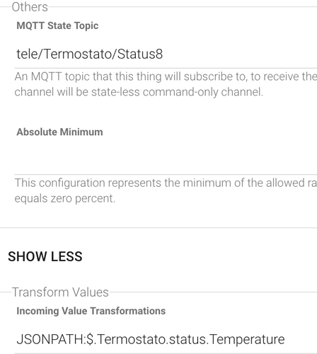

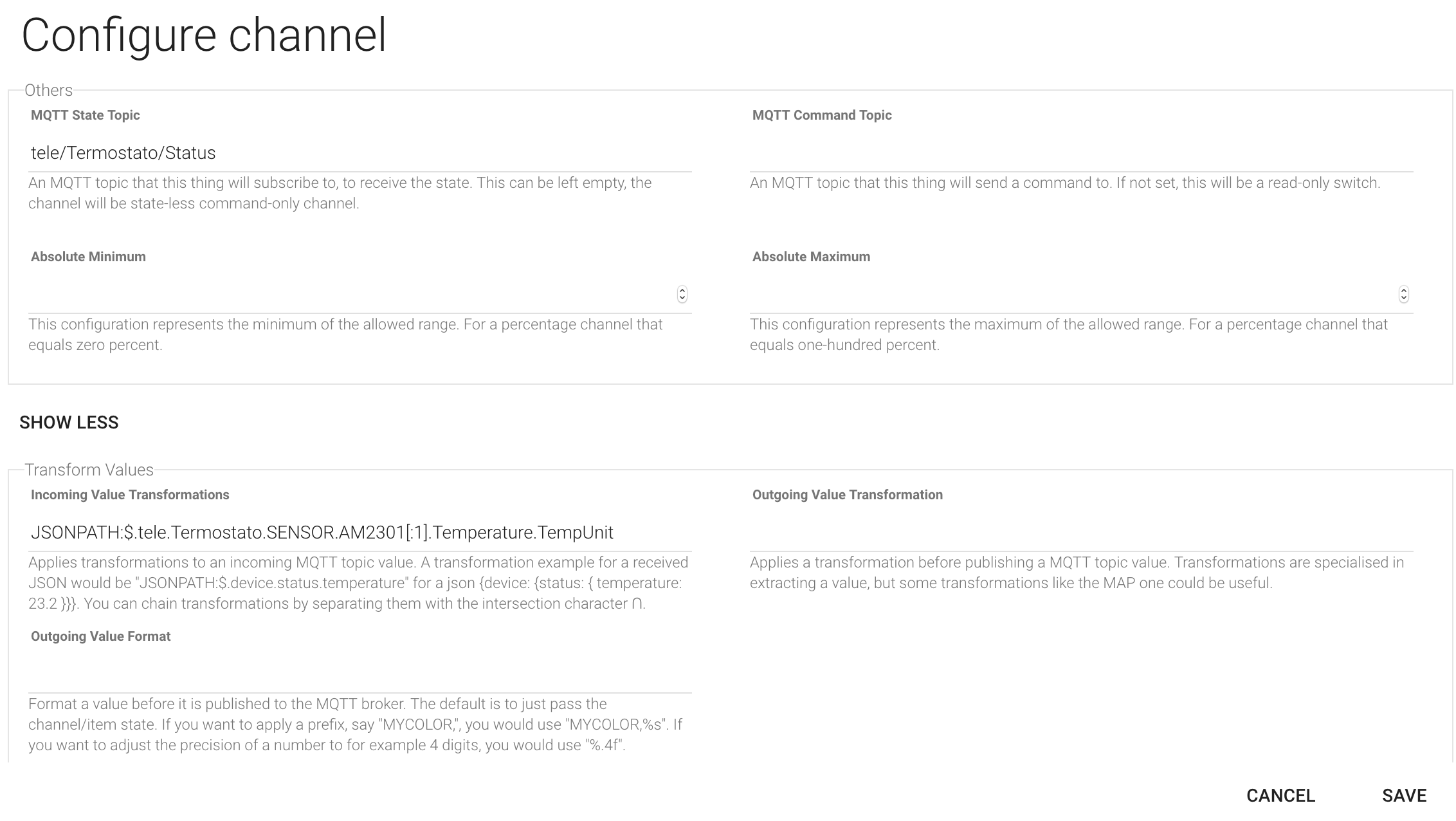

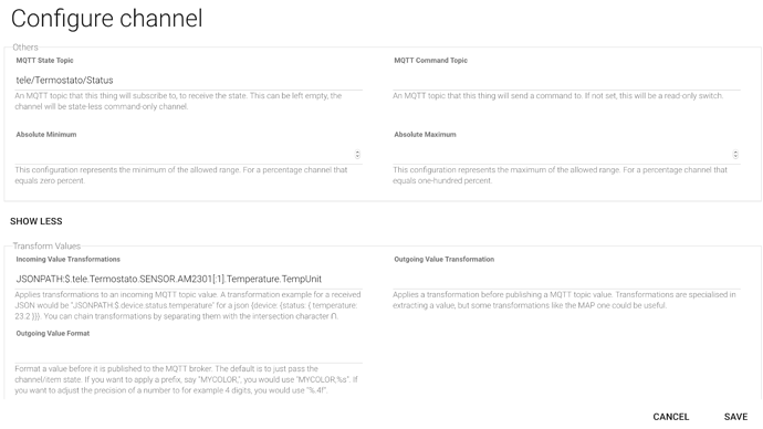

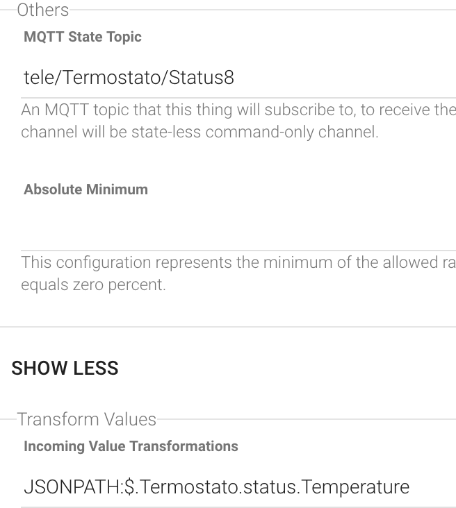

I tried different way like that …
but still nothing.

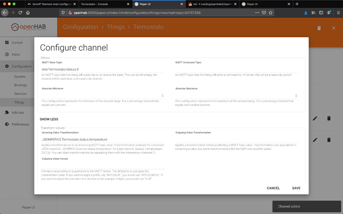

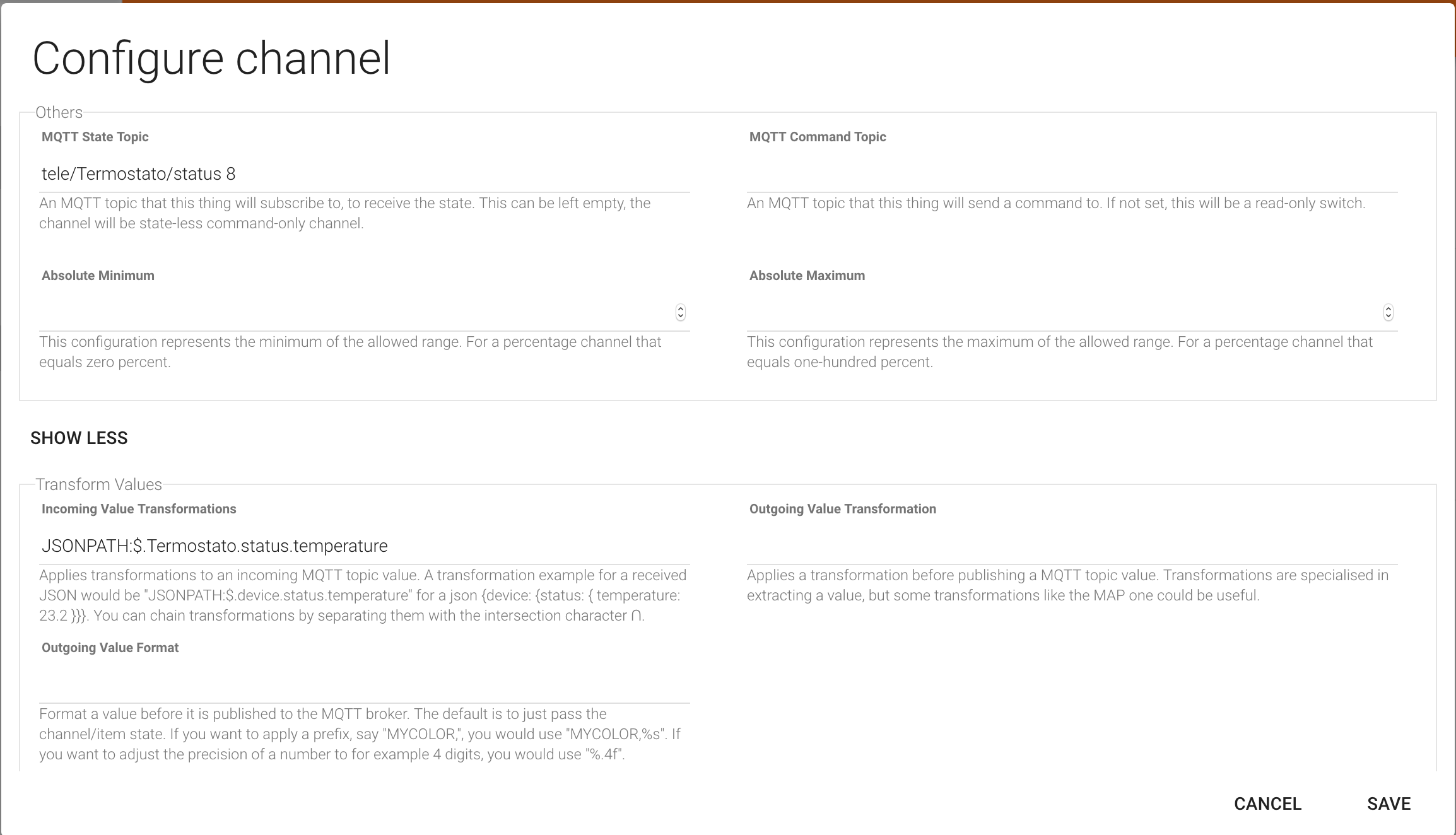

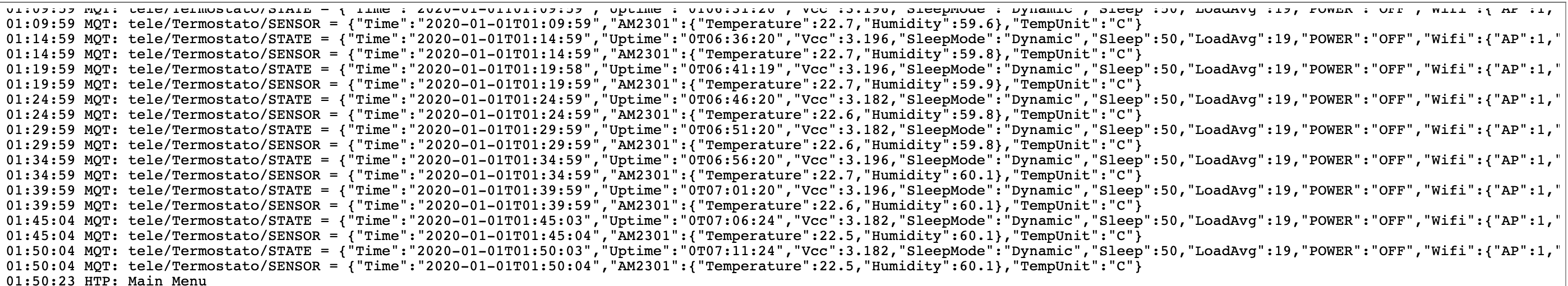

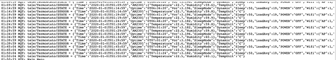

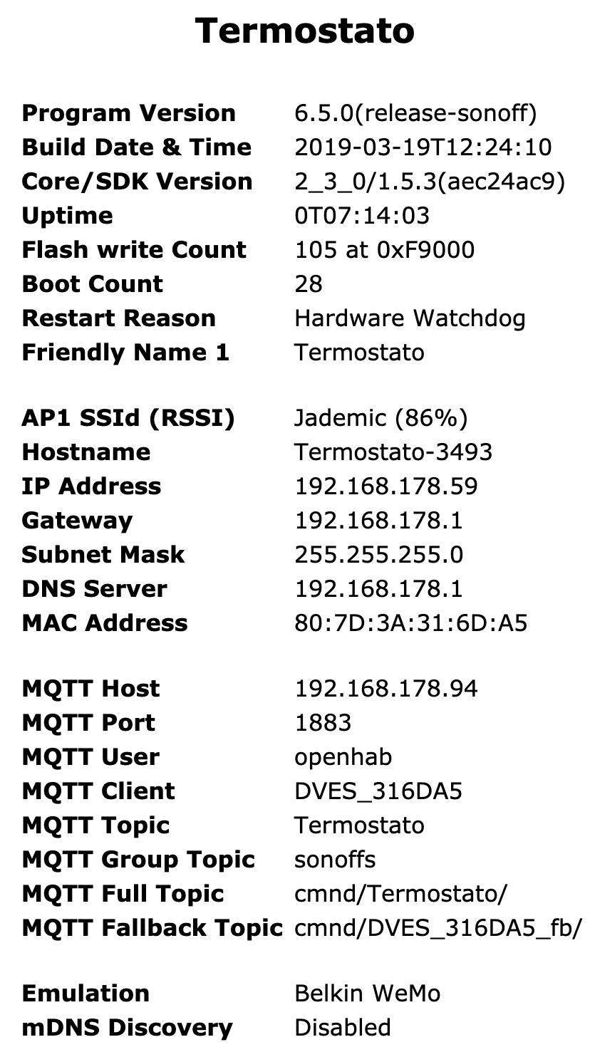

Show us a screen shot of your tasmota MQTT set-up.
Then post the actual JSON string that the tasmota sends, please. We really need that
Ok

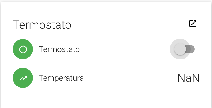

State topic: tele/Termostato/SENSOR
Incoming transformation:
JSONPATH:$.AM2301.Temperature
That’s it.
See: www.jsonpath.com to explore jsonpath
TnX,
I hade try also this solution, but I thought it didn’t work and even now that you suggested the solution it didn’t work initially, then I opened a new browser page instead of updating it and now it works.
Thanks so much
