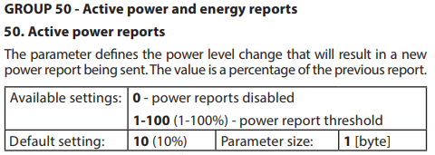

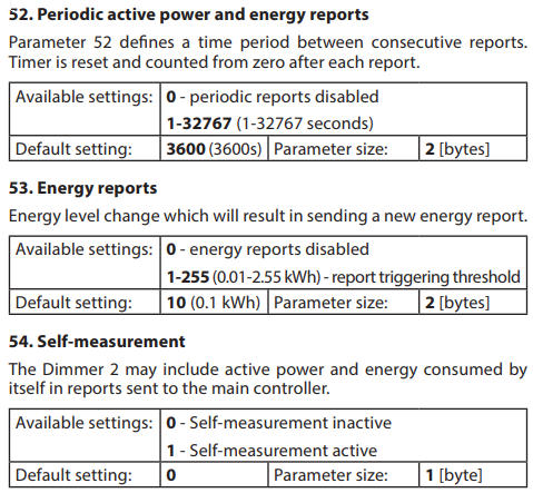

I’m pretty sure I’ve identified the z-wave parameters that should fix the issue but I’ve tried all sorts of combinations over the past week but cannot get it to report as it should. Reports range from 5-20 minutes it almost seems to be random, sometimes it reports the watts and continues to report them when the light has been off for hours.
I wonder if anyone else has one of these reporting correctly and if so what are the correct parameters or are there any tips that you can share?
Below are the parameters I assume control the reporting:
Currently I have the following set:
50: 1
52: 10
53: 10
54: 0
