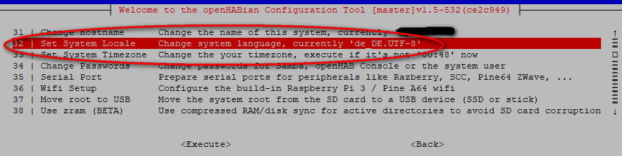

Sorry, I’m not that specialist, I only can say what I have done. This was my environment-variable printed out after I made a new install of openHAB … and got an warning-message from the install-routine at the end.
First I tried to correct it with openhabian-config ( no.32)
But the error still occurs.
After that I tried it the other way and the magic happened. I didn’t do that in a subshell, I just typed it in the command line.
BTW: I just read that post once again 'til the end. Now I’m wondering what happend :thinking: and understand what you mean.
