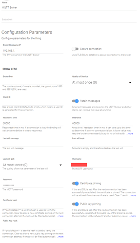

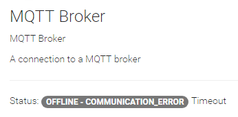

Now I want to begin the migration of my home server. I installed the mqtt2 binding and added the Generic MQTT Broker Thing. I cannot get it to connect to mosquitto.

I have restarted openHAB. I have cleared out the cache & tmp directories and restarted openHAB. I have checked and triple checked that I have the mosquitto host, user, and password entered correctly (I checked the Thing via REST to ensure that the password was correct). The broker Thing will not connect to mosquitto. I cannot figure out what I am doing wrong. Any guidance is appreciated.

When compairing the picture of your initial post to my setup (done via file, still on 2.4) I see an incomplete IP ( I guess that was on purpose) and that is all what differs (except user and password).

Your config looks very much like mine. I’d recommend not turning on Retained messages in the Broker Thing.
Try defining the client ID and make sure it is unique.
Try to connect to the broker using the same information using an MQTT client to see if the problem is in OH or in the connection info.

@rlkoshak - I deleted the broker Thing and recreated it letting openHAB pick the UID to ensure that it is unique. No change.

Not the UID of the Thing. I’m talking about the Client ID. Second row left column after ā€œSHOW LESSā€ in your screenshot.
I saw ID. I saw unique. I skipped right over the Client :wink:

Explicitly provide the port as well. A timeout error can really only happen if no connection could be established. Check firewalls and if the host is reachable.

I downgraded from 2.5.0~S1672-1 to 2.5.0~M2-1 and the Generic Broken connects and is online. I backed out the ClientID and the Port (both blank) and it still connects.
